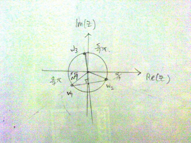

icystrike Messages 444 Reaction score 1 Thread starter Feb 22, 2010 #1 Homework Statement I'm looking at bii) of the question. Its my very first attempt at argand diagram and i do not really know how to construct one. Homework Equations The Attempt at a Solution Attachments LGIM0019.jpg 45.6 KB · Views: 589 LGIM0018.jpg 64.8 KB · Views: 597

tiny-tim Science Advisor Homework Helper Messages 25,837 Reaction score 258 Feb 22, 2010 #2 Hi icystrike! Your diagram looks fine … you've correctly drawn the three roots at -20º, 100º, and 240º. and the line you've drawn is the correct line. What is worrying you about that?

icystrike Messages 444 Reaction score 1 Feb 22, 2010 #3 cos I'm self-learning and does not have any tutor , thus , I'm here to check with you if I'm on the right track . Thanks tiny-tim ! (=
