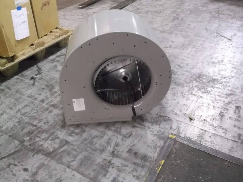

Hello all, i posted this on another forum but didn't get much response, I had an 18” centrifugal fan around around and wanted to see if I can push some real air to make a wind tunnel. I'm just a hobbyist, and like to build and modify cars, figured this would be something to look into.
Looks like this:
Trust me this thing is heavy and pretty big but is it big enough?

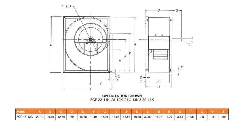

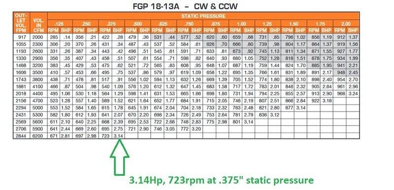

Spec picture Shown here page 107
18-13a, so 18 diameter with about a 18”x18” outlet.
Chart only goes to 723rpm but I got this up to just above 2000rpm, took 14Hp, I may add some more motors.

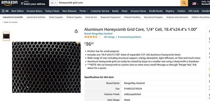

My question is the honeycomb, is it needed? Amazon has a few but they're 1/4" holes but only 1", i need probably around 3-6" for a honeycomb? any thoughts.

The honeycomb can be made from short thin-wall tube sections, cut from pipe, then glued side by side in a hexagonal pattern. Select the material and tube size you need. You may be able to throw out many redundant elements from the array where there are double walls not needed for structure.
would this work?
https://www.amazon.com/dp/B01AYIZ5MK/?tag=pfamazon01-20
The manufacturer's maximum rating for that blower is 3 HP. I wouldn't let anyone that I love stand anywhere near it at 14 HP.
I hear you Dullard, i told them to stand back. Haha. Thing is heavy, I over built it, 1.75" solid steel shaft almost 26" in length, pillow block balls bearings, but still need to reinforce it, the cage is not that sturdy.
kazx9r said:
would this work?
That will depend on the length and geometry of the airflow, how much untwisting is needed, and how much variation in velocity across the section can you tolerate? Will you close the airflow cycle?

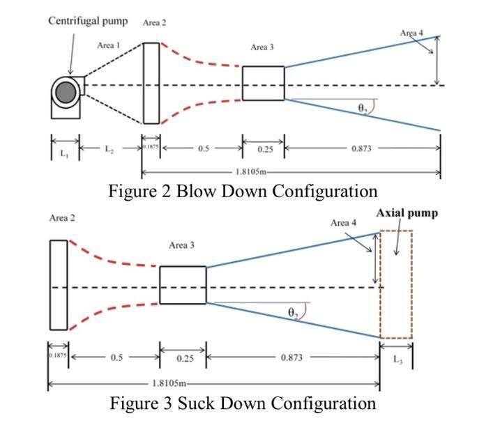

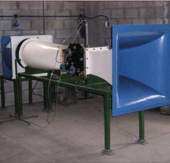

Someone posted this,
https://www.frh.utn.edu.ar/media/empresa/laboratorios/03_LA_fluidosytunel.pdf
is this what you have in mind? This looks similar to what I had in mind. So in order Fan, contraction, honeycomb, test chamber and then diffuser.

Thank you, I have no idea what the pdf says I meant the setup they had in it
That looks like a pusher fan so I’m going with a similar setup so we need to straighten out this airflow, I don’t think I can go with a puller setup. I have seen other setups with similar setups but I understand the pusher will take a larger fan but I think I have the size and power to achieve this part. Some other setups
The above used straws for honeycomb.

He’s probably more concerned about the fan blades failing from spinning it a 3 times the rated rpm. The applied forces on them should increase as ##F \propto v^2## in each principal direction( radially, and tangentially)?

I think that system is a first approximation to an open system. I would enclose the system in two distinct counter-flow channels.
You are working at low speed, well below the speed of sound, where air is assumed not compressible. Anything you do downstream will be reflected, to contaminate your test space. The test space needs a smooth flow without turbulence.
Put the test chamber in a restricted section of the front channel, with orderly contraction, collimators, and then orderly expansion.
Put the fan in the return flow channel where there can be some vibration isolation, noise and turbulence reduction.
Turning the corners between the two channels or ducts, with internal curved sheet guides in the bends, will be calming, and easier than designing and building an inlet horn for smooth flow, then working in the wind.
Start with several standard sized cardboard boxes, and discover why it is called "duct tape".
I get the thing about the safety and pushing this thing too fast, it needs to be checked for any blade damage or bending and also put some safety mesh.

thank you, I’m having a hard time visualizing this, any sketches of this setup online that you can link? All very interesting, thanks.
