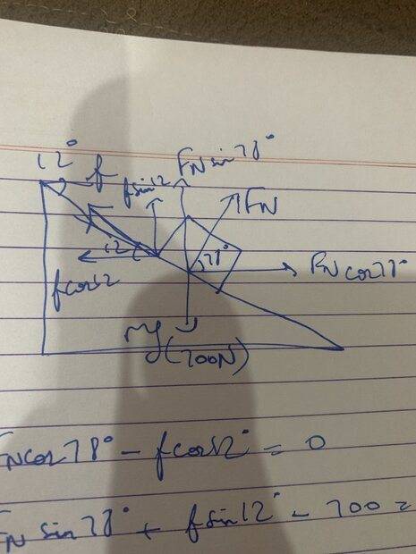

Suppose you weigh (mg =) 700N. You are standing (in equilibrium) on level ground. The coefficient of (static) friction between you and the ground is ##\mu_s=0.5##.
What is the contact force ##F_c## acting on you?
Hint: it is not ##700\sqrt{1+0.5^2}##.
Steve4Physics said:
What is the contact force Fc acting on you?
Well It should be 700N since friction is zero(Standing), not ##mumg##
OK, that is correct. Now suppose you weigh 700 N and you stand at rest on a rough plane inclined at 12° relative to the horizontal. What is the contact force on you in this case? Give magnitude and direction.
