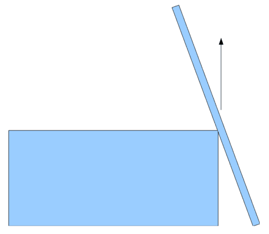

1. Direction of the normal
Definition: The normal force that body A exerts on body B is that force of minimum magnitude which suffices to prevent penetration of its surface.
X “the normal is at right angles to the horizontal”
Friction Diagram 1
This mistake tends to arise when one of the bodies presents a sharp corner at the contact point, e.g. a rod leaning against an upper corner of a block.
✓ The normal is at right angles to the contact plane
