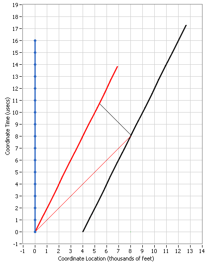

I think the easiest way to understand Special Relativity issues like this is to make a spacetime diagram including whatever you know from your description of the original Inertial Reference Frame (IRF), then use the Lorentz Transformation (LT) process to make another spacetime diagram to see what it looks like in another IRF and add more information, then transform back to the original IRF and see what a complete spacetime diagram looks like. The LT process will automatically take care of all three of the effects that DaleSpam mentioned.
Here is a diagram depicting the scenario that you described:
I am defining the speed of light to be 1000 feet per microsecond (usec). The stationary observer (let's call him the ground observer) is depicted as the blue line and since he is stationary in this IRF, the dots represent one microsecond increments of his time. The train is depicted as the thick black and red lines. The black line represents the black locomotive and the red line represents the red caboose. In the ground observer's IRF, the length of the train is 4000 feet and it is traveling at 0.5c or 500 feet per microsecond. Does this all make sense to you?
When the caboose gets to the ground observer, the passenger in the caboose emits a flash of light which travels at c to the locomotive. As you can see, it takes 8 usec to get there. When it does, a second flash of light is immediately emitted back toward the caboose (or there could just be a mirror there to accomplish the same thing). This reflected flash only takes 2.6 usec to get back to the caboose.

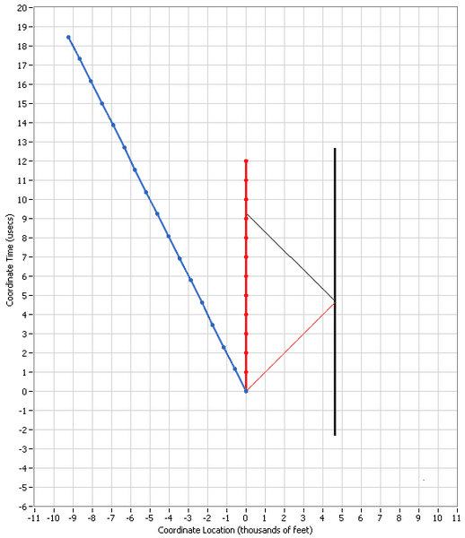

Now we will transform the scenario to the IRF in which the train and the passenger are at rest. We will also add in the dots that indicate one microsecond intervals of time for him:
As you can see, the train is about 4600 feet long in its own rest IRF and so it takes 4.6 usecs for the light to get from the caboose to the locomotive and another 4.6 usecs to get from the locomotive back to the caboose for a total round-trip time of 9.2 usecs. Note also that time for the ground observer is dilated--it takes longer for each microsecond to pass than for the coordinate time.

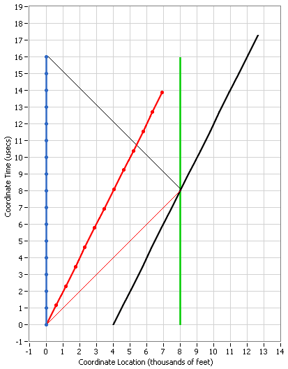

Now we can transform this new scenario back to the original IRF and add some more information:
What we have added is a green ground marker at 8000 feet that marks where the light "turned around" and we have allowed the reflected light to make it all the way back to the ground observer. In the ground IRF, it takes 8 usecs for the light to traverse from its source to the reflection point and another 8 usecs to get back to the ground observer.
Note also that time for the passenger is dilated so that he measures the same amount of time for the light to make the roundtrip as it did in the train's rest IRF. This emphasizes the point that any IRF is just as good as any other IRF for depicting all the information of a scenario.
I couldn't figure out what you meant by "the train travels through time with less speed" but hopefully these spacetime diagrams will make it all clear to you.

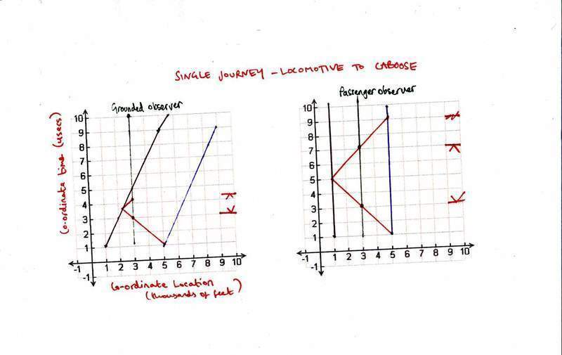

Thanks guys I really appreciate the help. Jhwellsjr thanks for the explanation it really helped, I hadn't been thinking about lights journey back to the grounded observer. I can see how this makes sense when light travels from one end of the train and returns to its starting point, but I'm still a bit confused. What happens if we asses a single journey, a light beam which only travels from the front to the caboose.
I have added an attachment of the graphs for this. I moved the line for the observer to the middle of the train I hope that's OK. It seems, in this case that for the passenger observer, the interval for the journey (front to caboose) takes longer than for the grounded observer (which it shouldn't because the train and passenger are moving). Is this a feature of SR that the light must travel a return journey? I hope this makes sense and it isn't too silly a question.
Thanks again

Your scenario covered both directions but you can look at just one direction and see what happens for the journey from the locomotive to the caboose. In the ground rest frame, the journey takes 2.6 usecs, as I mentioned at the end of the second paragraph under the first diagram in post #4 and in the train rest frame, the journey takes 4.6 usecs as I said below the second diagram.
It's OK but it really doesn't matter where the observers are for this kind of problem because it's a frame issue, not an observer issue.
That is correct and you got the same answer for the ground observer that I got, 2.6 usecs, and you would have gotten the same answer that I got for the passenger if you had drawn the distance between the caboose and locomotive correctly (remember, the train gets length contracted in the ground frame in which it is moving).

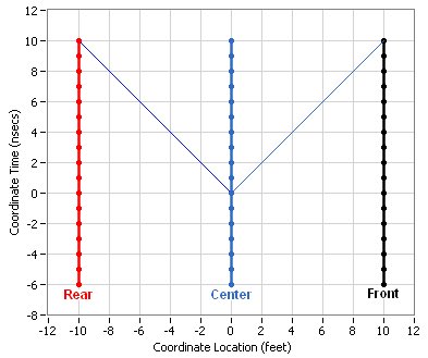

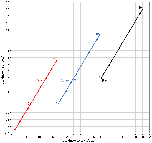

You always need to keep in mind all three relativistic effects: time dilation, length contraction, and relativity of simultaneity. Here is a brief example:
Suppose we have a train car of proper length 20 (in units where c=1). In the center of this train car is a flash bulb and there is a detector in the front and in the rear of the train car, and there is a clock next to the bulb and each detector with all three clocks synchronized using the standard synchronization convention. The train is traveling at v=0.6 relative to the embankment.
Now, in the embankment frame, when the clocks on the embankment read 0, the center clock of the train also reads 0, but the front clock reads -6 and the rear clock reads 6, this is due to the relativity of simultaneity. The front clock is located at 8 and the rear clock is located at -8, this is due to length contraction.
So, if the bulb flashes at when the clock on the train reads 0 (which is time 0 in the embankment frame) then, because the front of the train is moving away from the flash, it will not reach the front detector until time 20 in the embankment frame. Because of time dilation, the front train clock will only have ticked 16 times, and since it started at -6 it will read 10 when it receives the light from the flash. This matches with the fact that the proper distance is 10.
Similarly, because the rear of the train is moving towards the flash it will reach the rear detector at time 5 in the embankment frame. Because of time dilation, the rear train clock will only have ticked 4 times, and since it started at 6 it will also read 10 when it receives the light from the flash.

I have made a couple spacetime diagrams to illustrate your scenario. First the train frame:
And one for the embankment frame:
