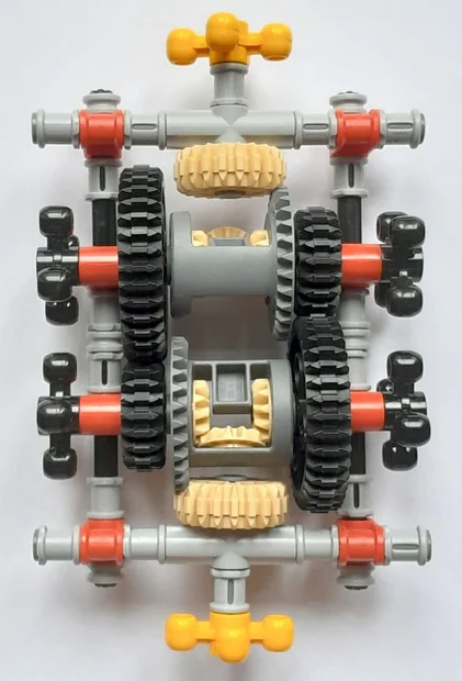

Seems like I gave up too early. But the insistence of @Baluncore made me more do more careful testing. And it looks like ratios other then 1:1 are indeed possible. Thanks and apologies to @Baluncore.A.T. said:![]()
Disappointingly it was exactly what I initially expected: A boring 1:1 transmission that merely reverses the direction (the yellow crosses rotate opposite to each other).
This part however is correct, and consistent with the formulas posted above by @jack action :
It was referring to this idea:A.T. said:Contrary to some claims in this thread, it is not possible to hold the output static, while turning the input continuously.
As @jack action derived above, one can fix the left or right side gears to switch the total gear ratio between minimum and maximum, given by the opposite side gears respectively. But you cannot hold the output static, while the input rotates, because the the total gear ratio can only be varied within a finite range.Halc said:One can for instance bolt the output to a wall, preventing any rotation. The input can still turn freely.

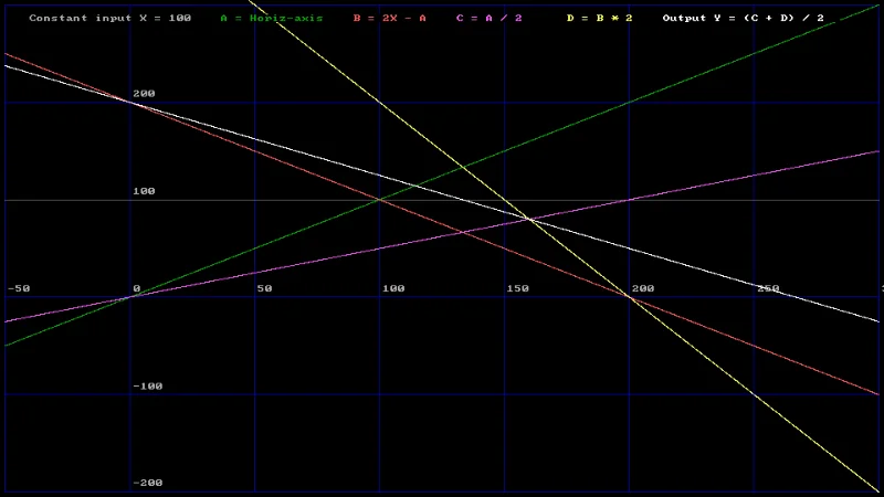

Here is a table that gives the speed of the shafts, all referenced to an input of 100. A and B are the input shaft gears, the average of A and B is X, the input. C and D are the output gears, the average of C and D is Y, the output. These definitions are compliant with those of jack action.
Here is the graph that shows gear ratio. The input X remains at 100%, the output is Y, the bright white trace, that can be read off as % gear ratio.

Look at the graph, or the table. The output, Y, crosses zero when;A.T. said:But you cannot hold the output static, while the input rotates, because the the total gear ratio can only be varied within a finite range.
X=100.0; A=266.7; B=-66.667; C=133.3; D=-133.3; Y=0.000
You can do that by clamping the output while turning the input. It is not however possible to brake gears to achieve Y≤0, since the speed of A must be accelerated, while the direction of gear B must be reversed. Reversal is not possible with a brake. Only ratios by a factor of two, between 200% and 50% are possible using brakes.

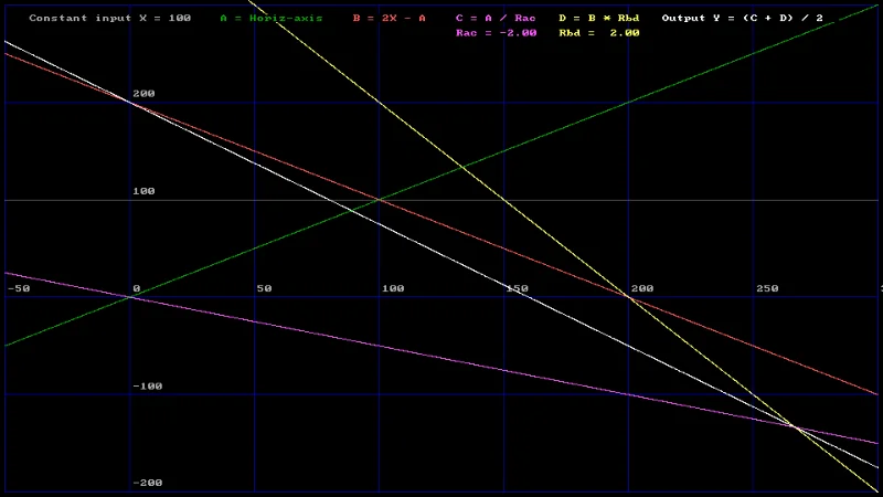

2025 Award
- 17,235
- 10,701
It is not possible to drive Y to zero, unless you brake Y itself. No matter how I juggle the ratios, one of the input gears must be driven negative to have Y = 0.
However, it can be achieved with a reversal, by inserting an idler gear into one, or the other gear train. It is then possible using a brake to have a bidirectional output that can be zero.
Here is a plot with one negative ratio coefficient.
Notice how A and B are positive, while Y can be negative.
