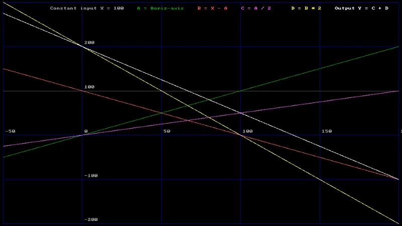

I named things differently to @jrmichler
The input differential drive is X, with axle shafts A and B.
The output differential drive is Y, with axle shafts C and D.
X (grey) = A (green) + B (red) ; input diff
A is geared to, C (magenta) = A / 2 ;
B is geared to, D (yellow) = B * 2 ;
Y (white) = C + D ; output diff
Now we fix the input X = 100 ; constant speed, call it say % or RPM.
We brake some shaft to control A (green), the horizontal axis.
The CVT ratio is then Y (white) percent.
Zero and negative output speeds are available.
Line graph of linear functions of horizontal axis A from -50 to 200 with constant input X = 100, showing A, B = X - A, C = A / 2, D = B * 2 and output Y = C + D.
We can apply a braking force to part of a differential to control output speed. This is equivalent to using a series resistor as a voltage regulator. It only works with a constant load.

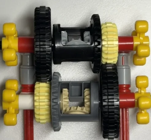

And now this is the diagram of the CVT I made without edits ontop:
LEGO model of a bevel gear differential built from black, yellow and grey gears, with yellow cross-shaped input and output shafts at each end of red axles.
My initial idea was that it's just a 1:1 transmission, because it's symmetrical: If you turn it around by 180°, you have the same gearbox but output and input labels are now swapped. But since differentials are counterintuitive and I had LEGO laying around, I just built it from exactly the same parts, but added shafts to the input/output (yellow crosses) to make their rotation clear.

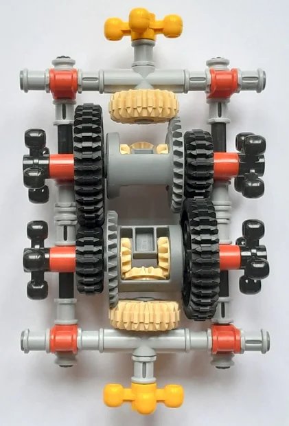

LEGO differential gearbox built from grey and black gears, tan bevel gears and red and grey axles, with yellow cross-shaped input and output shafts at the top and bottom.
Disappointingly it was exactly what I initially expected: A boring 1:1 transmission that merely reverses the direction (the yellow crosses rotate opposite to each other). Contrary to some claims in this thread, it is not possible to hold the output static, while turning the input continuously.
However, since it's all bendy plastic and loose gear meshing, it's possible to turn the input by about 45° while the output is held static, before it locks up or gears start skipping teeth. This is what might have confused the OP, who didn't use input/output shafts, and was applying forces to the differential carriages with slipping fingers.
