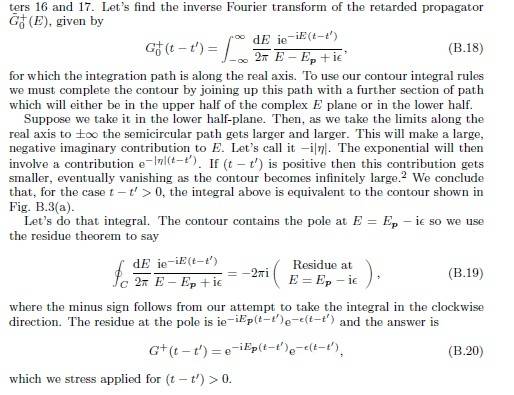

Hi,
I've never studied compex analysis before but I am trying to understand this example from "QFT for the gifted amatur".
I don't understand why the residue at the pole is e-iEp(t-t')e-e(t-t'). How did the find e-e(t-t')?
Thanks.
Well, he (or she) starts with the function:
\dfrac{i e^{-i E(t - t')}}{E - E_p + i \epsilon}
The residue of a function of the form \dfrac{A(E)}{E-K} is just A(K). In this particular case, K = E_p - i \epsilon, and A(E) = i e^{-i E(t-t')}, so the residue is i e^{-i (E_p - i \epsilon) (t - t')} = i e^{-i E_p (t-t')} e^{- \epsilon (t-t')}
