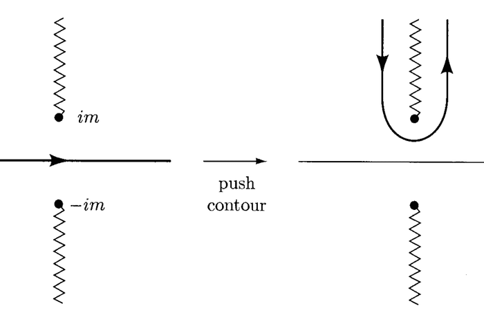

1. I'm having some trouble with some of the contour integrals covered in Chapter 2 of Peskin & Schroeder's Intro to QTF. I'm not so much as looking for answers to the integral (in fact, the answers are given in the textbook), but I was hoping someone could point me to some resources to use to become more familiar and confident with integrals like this as so far my understanding of it is very "hand-wavy."
: In section 2.4 of P&S, the propagator for the Klein Gordon field is derived and found to have the form: $$D(x-y) = \frac{-i}{2(2\pi)^2 r} \int_{-\infty}^{\infty}{dp \frac{p e^{ipr}}{\sqrt{p^2+m^2}}}$$
Now, I can readily see how this is a contour integral along the real p-axis with (isolated?) singular points at $$p=\pm im$$
But, I'm not familiar with the contour deformation done in the book:

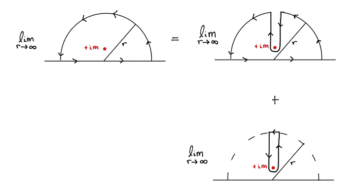

Okay, I think I get it now after thinking about it some more:
So the integral $$\int_{-\infty}^{\infty}{f(p) dp}$$ can be closed above the p-axis by adding a term (and subtracting off the same term to make sure the integral remains unchanged): $$\int_{-\infty}^{\infty}{f(p) dp} = \int_{-\infty}^{\infty}{f(p) dp} + \lim_{r\rightarrow\infty}\int_{0}^{\pi}{f(re^{i\theta})ire^{i\theta} d\theta} + \lim_{r\rightarrow\infty}\int_{\pi}^{0}{f(re^{i\theta})ire^{i\theta} d\theta}$$
But since the integrand of both the new terms go to zero as r goes to infinity, you can set the third term to zero and keep the second term at no cost. Now, since I have a closed contour, I can break down the following contour like I drew here:
And since the first contour in the image does not enclose any singularities, that term is zero leaving only the second term, which is precisely the contour deformation done in Peskin & Schroeder.
Is that correct?

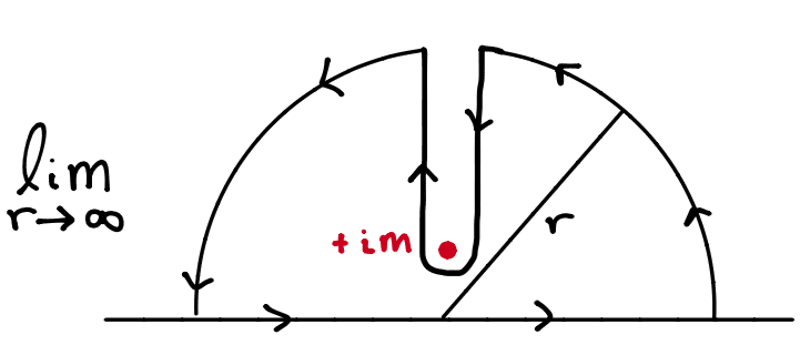

Equivalently, but perhaps a bit shorter, is to consider just your middle figure. The integral around the entire contour is zero. Integrals along the arcs at infinity are zero. So, the integral along the real axis must be the negative of the integral along the "dipping" portion of the contour.
That makes a lot of sense, too. So basically by flipping the direction of the "dipping" portion of the contour you make the two equivalent. Makes much more sense now, thanks!
Hello all, I have a additional question to this topic ( I don't regard is at off-topic which is why I didn't open a new thread. If I'm mistaken, please correct me). In general I understand the argument made above, but I do not see, why one can use the residue theorem, since by closing the contour across the line $$[im,\infty)$$ one crosses the branch cut and therefore the integrand is not continuous along the path and so is not analytical. Lev
Good point, Lev.
The integral that you want to compute is the one around the branch cut. I think you would agree that the larger contour with the notch cut out encloses a region where the function is analytic, and therefore would have an integral equal to zero.
Instead of using Cauchy's thm to simplify the contour, we could more generally use the concept of path independence. Define a domain D such that the function is analytic everywhere on D. Then, through path independence, any other path between the points should have the same value.
In this case, our path is between ##-\infty## and ##+\infty##. Using the same rationale, we can justify setting some pieces of the contour integral to zero in the limit near infinite radius.
