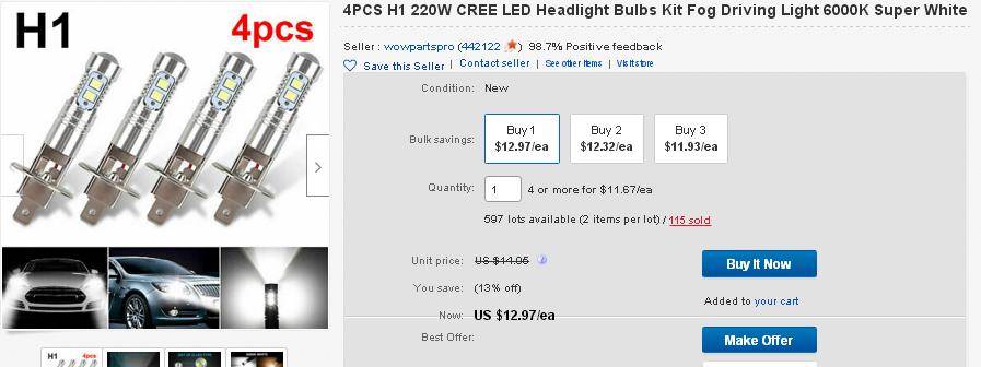

I want to change the the old round 5000 series filament bulbs to led. I attached a picture of some I found on Ebay. I see some led bulbs seem to mention some thing about fan. One way would be cut hole in old glass bulb and glue led in with silicon. Could use glass jar and drill hole in cover and insert led . Then would there be an issue with focusing light?

I don't know the local regulations valid for you, but (for example) in Europe car lights are safety issue, thus glues and tinkering and such are not legal.
Even some ready made 'I swear it's compatible' LED replacements won't be by the book.
So I suggest you think twice before starting.

One issue is focus. Filament lights are designed to focus a tiny filament to a spot at distance. The much larger LED will have a much wider spot at distance.
Another issue is that "drop in" replacement LEDs need to have a built-in electronic circuit (which can't tolerate high temperatures) to downconvert the 12V to the levels needed by the LEDs. Even if you had a separate converter, the LEDs themselves have much lower temperature limits than filament lights.

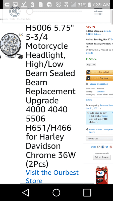

I see replacement on amazon for the 5006 but quit exspensive though.

5006: Common automotive headlight, High/Low beam;
rated 12.8V, 35W each of two filaments, 320hrs rated life;
envelope is PAR46, Parabolic Reflector, 4.6 inch diameter;
meets US federal DOT (Department of Transport) standards for use on public streets roadways.
Approx retail price: $11-$16 depending on retailer.
Cheers,
Tom
If you now have PAR46 sealed beam, then you must replace it with another sealed beam;
Or fit PAR46 semi-sealed beam reflectors, so you can install an LED with the appropriate base.
Search; 'PAR46 Semi Sealed' on eBay
Or just look for PAR46 LED.
H4 base Hi/Lo beam LEDs have fans and may need a simple circuit to operate correctly with the Hi beam indicator on the dash.

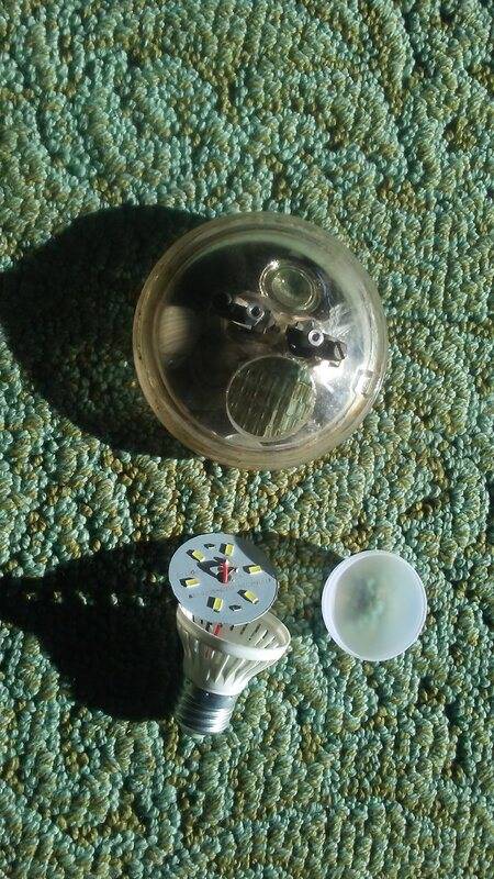

I did some smaller tractor lamps , made hole took 30 watt 12 volt household bulb took out circuit board used silicon to hold and seal works good.
