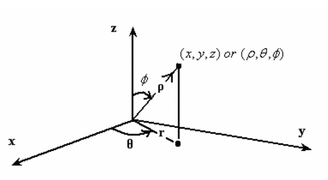

Hi
I have an expression on the form
[tex] df(v, \theta, \phi) = v e^{-v^2/C}\cos(\theta)v^2\sin(\theta)\,dv\,d\theta\,d\phi[/tex]
and I am trying to write it in cylindrical coordinates. Note that θ runs from 0..π, v is a velocity and C a real constant. So I wish to write it in terms of a radial and axial velocity, vr and vz.
First I thought of integrating out θ and [itex]\phi[/itex]. [itex]\phi[/itex] is easily done, and it yields 2π. However, the integral over θ yields 0. Am I doing this wrong?
The result should yield something proportional to
[tex] v_re^{-v_r^2/C^2}v_ze^{-v_z^2/C^2}\,dv_r\,dv_z[/tex]Niles.

Ahh, I think I get it now. So what you mean is that
[tex] v\,dvd\theta = dv_r\,dv_z[/tex]
Then it adds up!
In cylindrical coordinates r measures the distance from the origin to the foot of the projection from the point to the xy-plane. The line from the origin to the point in 3 dimensions, the line from the origin to the point at the foot of the projection and the projection form a straight line with hypotenuse of length [itex]\rho[/itex], angle [itex]\pi/2- \phi[/itex], "opposite side" of length z, and "near side" of length r. That is, the point that has spherical coordinates [itex]\rho[/itex], [itex]\theta[/itex], and [itex]\phi[/itex] has cylindrical coordinates [itex]r= \rho sin(\phi)[/itex], [itex]\theta= \theta[/itex] and [itex]z= \rho cos(\phi)[/itex].
Here, I have used the mathematics convention that [itex]\theta[/itex] is the "longitude" and [itex]\phi[/itex] is the "co-latitude". The physics convention reverses that.
My understanding of the problem is in the attached graph below.
In this problem, [itex]\phi[/itex] is substituted by [itex]\theta[/itex], [itex]\theta[/itex] is replaced by [itex]\phi[/itex], and [itex]\rho[/itex] is replaced by v.
So, a description of the sphere would be:
For [itex]\phi[/itex] and [itex]\theta[/itex] fixed, [itex]v[/itex] varies from 0 to v.
For [itex]\phi[/itex] fixed, [itex]\theta[/itex] varies from 0 to ∏.
[itex]\phi[/itex] varies from 0 to 2∏.
The corresponding description in terms of cylindrical coordinates would be:
For [itex]\phi[/itex] and [itex]r[/itex] fixed, [itex]z[/itex] varies from [itex]-\sqrt{v^2-v^2\sin^2\theta}[/itex] to [itex]\sqrt{v^2-v^2\sin^2\theta}[/itex], where [itex]\theta[/itex] is [itex]\arctan ({\frac {r}{z}})[/itex].
For [itex]\phi[/itex] fixed, [itex]r[/itex] varies from 0 to v.
For the integrand:
[tex]v e^{-v^2/C}\cos(\theta)[/tex]Replace [itex]\theta[/itex] by [itex]\arctan ({\frac {r}{z}})[/itex] and [itex]v[/itex] by [itex]\sqrt{r^2+z^2}[/itex].
