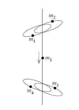

Noncollision Singularities (Xia)
Worse than that, Xia proved in 1992 that with 5 or more particles, there are solutions where particles shoot off to infinity in a finite amount of time!
This sounds crazy at first, but it works like this: a pair of heavy particles orbit each other, another pair of heavy particles orbit each other, and these pairs toss a lighter particle back and forth. Xia and Saari’s nice expository article has a picture of the setup.
Xia's construction, from Saari and Xia's review paper
Xia’s construction
Each time the lighter particle gets thrown back and forth, the pairs move further apart from each other, while the two particles within each pair get closer together. And each time they toss the lighter particle back and forth, the two pairs move away from each other faster!
As the time ##t## approaches a certain value ##t_0##, the speed of these pairs approaches infinity, so they shoot off to infinity in opposite directions in a finite amount of time, and the lighter particle bounces back and forth an infinite number of times!
Of course, this crazy behavior isn’t possible in the real world, but Newtonian physics has no ‘speed limit’, and we’re idealizing the particles as points. So, if two or more of them get arbitrarily close to each other, the potential energy they liberate can give some particles enough kinetic energy to zip off to infinity in a finite amount of time! After that time, the solution is undefined.

  16. john baez
    john baez says:
    May 19, 2016 at 5:08 pm
    “The lack of solutions for 5 or more particles isn’t related to the Abel–Ruffini theorem? Or is it just a (temporary) coincidence?”
    Probably nothing to do with the unsolvability of the quintic. Right now the situation is this:
    [LIST]
    [*]With 5 particles we know it’s possible for Newtonian point particles interacting by gravity to shoot off to infinity in finite time without colliding.
    [*]With 4 particles nobody knows.
    [*]With 3 or fewer particles it’s impossible.
    [/LIST]
    and:
    [LIST]
    [*]With 3 or fewer particles, we know the motion of the particles will be well-defined for all times “with probability 1” (i.e., except on a set of measure zero).
    [*]For 4 or more particles nobody knows.
    [/LIST]
    Log in to Reply
