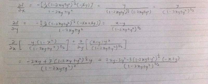

I have calculated 3 times and I still don't get the answer. The answer should be 0.
Here's the question and my work. Which part am I wrong?
f(x,y) = 1/√(1-2xy+y^2)
Prove that ∂/∂x{(1-x^2)*∂f/∂x} + ∂/∂y{(y^2)*∂f/∂y} = 0
  • Handwritten partial derivative working on lined paper: ∂f/∂x and ∂f/∂y for f = (1-2xy+y^2) to the power -1/2, then the second-derivative terms of the combined expression.
haruspex said:
The powers "-1/2" in the very first step for both fx and fy should be "+1/2".
I think my first partial derivative is correct.
because the power of the original function is +1/2 so when we differentiate it,it becomes
1/2 - 1 = -1/2
But I don't get 0 for the final answer
Sorry, you're right. The mistakes are in the last line.
In fact, hardly any of the last line looks right to me!
E.g. the first term should be (writing g = 1/f):
[-2xyg3 + 3y2(1-x2)g]/g6
No?
No?
Yeah, I know what went wrong now :D I used the quotient rule incorrectly.
Thanks, I have solved this! :)
