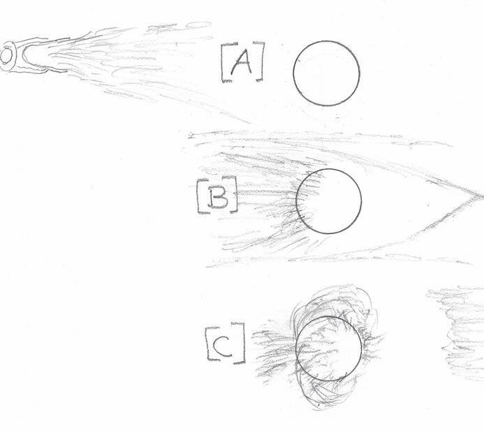

I saw a physics problem on Craig’s List (of all places) that piqued my interest. I’ll paraphrase it:
An astronaut on the ISS placed a large magnetized sphere outside the station far enough where the station had no effect on the magnet then threw a large pail of iron filings at the sphere. He was wondering if some of the filings would form rings around the sphere. What did he see? What if the sphere was rotating?
What do you think would happen?

For the non-rotating sphere, I think the filings will all be attracted to the sphere and will make their way to it and stick to it. The key is that the field is very non-uniform, which exerts an attractive pull on the metal filings:
https://www.mezzacotta.net/100proofs/images/008-Dipole.png
In the case of a rotating magnetized sphere, it depends on whether the rotation is about the magnetic axis or perpendicular to it. If it is rotating about its magnetic axis (about the vertical axis in the diagram above), then I don't think it's much different from the non-rotating case. If it is rotating about a perpendicular axis so that the magnetic poles are spinning around, that will modulate the strength and direction of the B-field in space, and will cause an erratic but still attractive force on the filings.
In either spinning case they should still all be attracted and make it into stick to the magnet, unless as you say the rotation is so fast that they gain enough kinetic energy to fly back off.

This is an interesting thought experiment. Thinking of the iron filing and the magnetized sphere as two dipoles, I don't think the force between them follows an inverse-square law. There is a fun little theorem called Bertrand's theorem which tells us which kind of central potentials have closed, bound orbits. But I'm not sure the theorem applies since the force between dipoles depend on their orientation.
This is all to say that even you didn't toss the filings directly at the sphere, there may not be an initial velocity that allows a ring to form (a ring being indicative of a closed and bound orbit). Anyway, I'll stop handwaving now.

For two dipoles the general scaling is 1/r4 multiplied by a term that depends on the relative alignment. It's growing too fast with decreasing distance, so there won't be any stable orbits. Everything escapes or sticks to the magnet.

I don't think it has to be 1/r^2, but I think it has to tend to 1/r^2 from a field with a characteristic 1/r^(less than 2). By that means the gradient of the potential will mean something can drift out and find its 'natural' solution, if there is one.
My prose explanation (sans equations) for this would be;
For a permanent magnet it may tend to 1/r^2 at some point but it tends from 1/r^3 in its nearfield. This would mean the energy gained by some small perturbation inwards will be greater than a omega^2 function (as angular momentum must be preserved, even if the orbiting particle gains radial kinetic energy).
So the result is that if the field is stronger than 1/r^2 then an orbiting part will have to gain inward radial kinetic energy for an inward perturbation (or vice versa lose outward kinetic energy) if it is to preserve angular momentum (i.e. heads for the magnet or spins off).

They would all end up at the magnet or escape. On Earth other forces can keep them elsewhere, floating in space there is nothing that stops them from going to the magnet.

Thank you all for your opinions on this thought experiment. If I understand properly I can visualize the experiment as follows:
The magnetic sphere is placed outside the ISS at some distance not spinning. A limited quantity of iron filings is gently wafted in a cloud at a distance of 40 times the radius of the ball. At first the cloud hangs together moving slowly in straight lines [A]. Then the filings closest to the ball begin to veer conically toward the ball accelerating first to the closest pole growing spikes quickly then as the height of the fill reaches a certain point the remaining filings form spikes steadily back toward the other pole along the field lines until there are no more filings left for symmetry and so we are left with a tear-shaped spiky ball [C]. Had there been lots of filings there would eventually be a symmetrical distribution. Or would there be a symmetric distribution no matter the quantity of filings. Meanwhile, the outer most filings waft by the ball in a straight line headed to far space. The filings just a bit nearer the ball bend a bit, pass the ball, and continue into outer space at an angle . As an aside, if we suddenly demagnetized the sphere the shape would hold as there is no force to accelerate the organized filings.
Now, as I think what Berkeman said earlier, in the case of a rotating sphere about the magnetic axis or even perpendicular to it, the image of the final steady state [C] would not significantly change.
