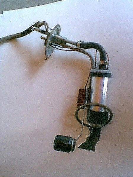

Rather than worry about cell phones, maybe you should worry about your fuel pump.
http://www.lunghd.com/Tech_Articles/Fuel_System/Fuel_Pump_Replacement.htm
The flat disc towards the top left is the part that fits to the outside of the fuel tank. Everything below that, the pump, the fuel level sensor, the sock filter, and the wires sit inside the tank, submerged by gasoline.
Once you've finished and it comes time to start your vehicle for the first time, you can't help but pause and wonder whether you've installed a new fuel pump inside your tank or if you've installed a bomb inside your tank.
