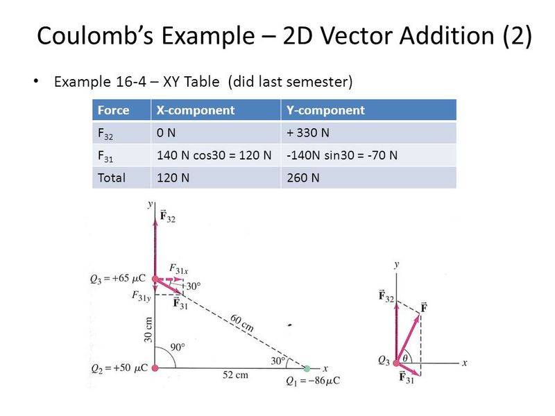

This is finding net force on Q3.
I was taught by my Physics teacher to always get angle from the Positive side of x-axis (+X-Axis).
For example in the above situation, if the angle is -30deg from the +x-axis (assuming the Q3 is the origin),
Why is F31 x-component = 140 N cos(360-30) NOT the case?
I mean I considered that in getting angles it should ALWAYS come from the +X-Axis
I think now, if the above x-y components are correct. then the cartesian plane (Q3 Origin) is turned upside down
Now, what's not clear to me is that. When does a Cartesian plane mirrors/turns upside down?
OR is the above situation false?
Since the cos() function is even, cos(-θ) = -cos(θ) cos(θ), so it doesn't really matter whether you take that angle as positive or negative, as long as the resultant is pointing in the correct direction.
Probably a better way to think of is is to just use vector dot products to keep the directions straight. Are you familiar with the vector dot product?
EDIT -- fixed typo in my cos() equation.

Stenn said:
the above is cos(360-30) = cos(330)
They are all the same. cos(x)=cos(-x)=cos(360-x). Flipping the image about the x-axis does not change the x components of the vectors.

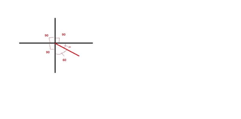

I want to change the question. How do I plot the origin? in order for me to determine the angle.
I want to change the question to. How do I plot the origin?, for me to determine the angle I need for breaking down x-y components of a vector
I don't understand your question. To find the components you only need the angle the vector makes to the directions of the x and y axes. The origin can be anywhere.

You see the above. There is given -30deg
We all know in a cartesian plane there would be 360 degrees all in all around.
Now, -30 deg from x-axis would be 30 degrees BACKWARDS
Now, I was taught by my professor to ALWAYS START FROM X-AXIS forwards (I think this part is where I get problems)
Now, I think is that I would use cos(340) to get the angle and
resolve x-y components with the angle 340 from x-axis
So, I need origin to imagin cartesian plane on an reevolve around and get the angle of a vector.
