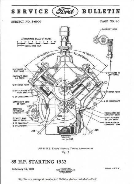

Henry Ford was aware and slightly offset them in his legendary Flathead V8, in production from 1932 thru 1953..
http://forums.autosport.com/topic/126663-cylindercrankshaft-offset/

Here's Henry's 1932 V8 it shows the desaxe offset, 0.158 inch

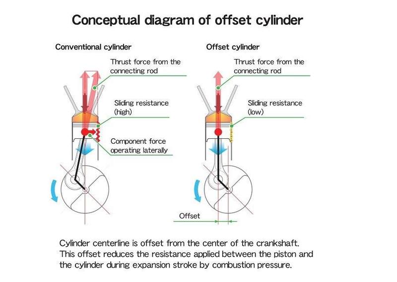

Here's as good a layman's illustration of the side friction effect as I've run across. It's from a motorcycle site.
https://rideapart.com/articles/free-power-offset-cylinders-explained
