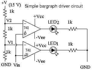

So I decided to use allaboutcircuits simple bargraph driver circuit (where the component values were not shown) and decided to use my own values.
For the opamp I have decided to use LM741 (since it is easily available). For the resistors which are connected in series with the diode I decided to use 1k ohm resistors ,so as not to harm the LEDs.
I have decided to use the red LEDs.
For the resistors I which are directly connected to the V+ I have decided to use three 1k ohm resistors.And I will take V+ as 15 volts. Now the problem is how to calculate V1 and V2 .Since V+ is getting divided into two parallel branches one into the three 47 ohm resistors and the other into the opamps, I wonder how to calculate the resistance of the opamp branch.
I think I am stuck up. Experimenting in the lab is not a good option right now since my college is far away and its holidays for 2-3 days now.

The values of the resistor divider on the left are not important. Just shoot for maybe 10mA in that divider. The resistors in series with the LEDs most certainly can't be 1M Ohm as you've drawn. What forward current do you want in the LEDs (look at their datasheet)? What is the LEDs' typical forward current? What voltage will be across the LED+resistor when it is on? That sets the value of the LED resistors.

Actually I am supplying +15 volts to pin 7 of IC741 and -15V to pin 4 of the IC.
Even without giving any supply to the +V & Vin both the LEDs glow.
Actually when pin 7 & pin 4 were connected as above, +V was at 5V & Vin was at zero, both the LED’s glowed. Using multimeter I noticed that the voltage across the LED2 was 7v .When I increased Vin to 0.1V the voltage across LED2 went to 13.3V & further increase in Vin didn’t lead to further changes.
At the same time the voltage across LED1 was 9.5V(when Vin was at 0V) & 13.19 V (when Vin was at 0.1V).
Increasing Vin further didn’t change the voltage drop across LED2.
Increasing the values of resistors only decreses the intensity of light of the LEDs.
I fail to understand why it’s reaching saturation so early, how should I modify it?
Several issues with that circuit. First, LM741 opamps are not a good choice for comparators. Second, comparators should have some positive feedback for hysteresis, or they will oscillate when the + and - inputs are close to each other (which will happen a lot in a bargraph application like this).
Third, since the input and output are ground referenced, you usually would use a single supply opamp or comparator that includes ground as a valid input. Since you have a -15V supply, you need to look into what the maximum reverse voltage is that the LED can tolerate. LEDs generally do not have high reverse standoff voltages.
Look into single-supply comparators, to see if they would work better for you, and be sure to add hysteresis to all of your comparators (or opamps used as comparators).

Is 741 really imp?Because here op-amps are expensive and the place where they are sold is far away. So I need to be very clear about which op-amps I should be getting.I performed a search and got this list for single supply op-amps.http://search.datasheetcatalog.net/key/SINGLE+SUPPLY+OP"
Out of them LM7131 seems to be the simple one.What other characteristics should I be looking out for?

Actually I don't anything about my LED except that they are red in color. I just found them at my home.But a search on google revealed red LEDs having max reverse current flow from 10uA to 100uA.Ironically I don't remember burning more than 4 LEDs in the 15 or so times we rebuilt the circuit and tested it.
Someone suggested me that since the opamps are going into saturation , I should use a negative feedback. To me using positive and negative feedback both seem correct.Anyways never used positive feedback,so what value of resistor should I be using or how do i calculate it?
