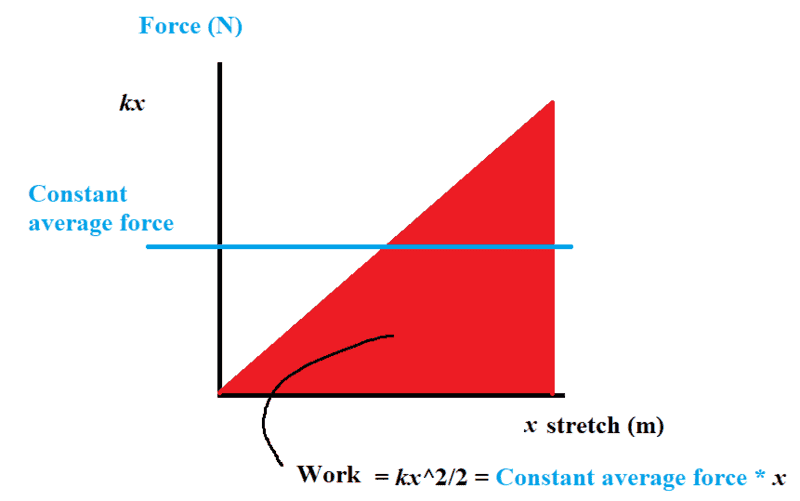

This link shows an easy graphical method to show where the 'half' factor comes from. This diagram is explained fairly well in the link.
Visualise stretching the spring a tiny bit at a time. The force will not change noticeably so the work done will be kx times the small stretch Δx. The total work done will be the sum of all those small stretches, which is represented by the shaded part of the triangle. Area is half base times height.

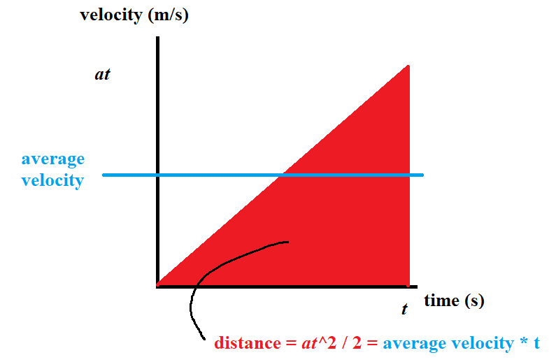

same graph as above, but imagine there was a constant average force instead stretching the spring x. This average force would be kx/2 and the work done would be kx2/2.
You are probably familiar with this method in finding the distance traveled when you have constant acceleration.
I don't think you actually meant that. The force to keep the spring at x would be kx (not half). If that force were applied over a distance x then the work would be kx2. That's twice as much as if the force is build up gradually.
I used to have terrible problems with that until I stopped thinking of a practical car engine. No one stressed the 'constant acceleration' enough to get through my thick skull.
