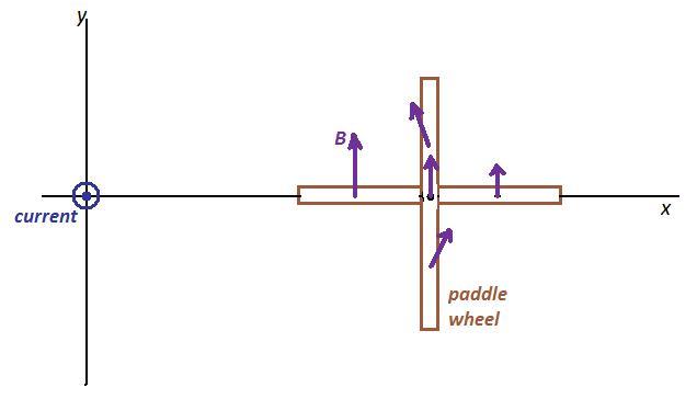

Per Maxwell's equation and my H. H. Skilling EM textbook, curl H = 0 in the absence of current density.
But consider a long, thin wire along the z axis carrying time-invariant current I. By Ampere's law, at a point (x,0) outside the wire, H = I/2πx j . But curl H computed by Cramer's rule from the curl determinant is not zero.
2. Relevant equations
curl H = J + ∂D /∂t
2πxH = I
Since I is time-invariant there is no time-varying electric field so ∂D/∂t = 0.
Since H = H j = I/2πx j at (x,0),
curl H = ∂H/∂x k - ∂H/∂z i
but for a long wire, ∂H/∂z = 0 so we wind up with
curl H = dH/dx k
= -I/2π x2 k ≠ 0.
So how is the paradox resolved, please? If you're familiar with the concept of little "paddle wheels" (Skilling uses) indicating curl, even there it seems curl H ≠ 0 outside the wire.
All glory and thanks to the resolver!
If you want to work in Cartesian coordinates, then first work out the general expression for the components of H in terms of x and y. Since you are going to take derivatives, you don't want to let y = 0 until after taking the derivatives.
I switched to cylindrical coordinates, and lo & behold ... :smile:
I won't bother with the cartesian but obviously am now a Believer! Thanks again, will get to sleep a bit faster now ...
