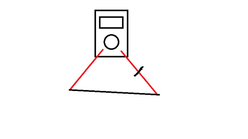

The question wants to know why th current should be small through a wire when using an ohmmeter.
None
I can't think of a solution, and looking online doesn't give any answer.
How do you think an ohmmeter measures "ohms"? What information online did you get about that? There is a very relevant equation equation involved.

I am not asking you to find a diagram. I am asking you to draw one that shows the basic elements you need for the measurement. Start with the resistor you want to measure. Draw it. What else do you need to have a current through the resistor? Draw that too. Can you do that?

I can try, keep in mind that the resistor, isn't an actual resistor, but a metal wire, which acts like a variable resistor.

I think you can safely assume that the wire has a fixed length which means a fixed non-zero resistance for answering this question. If the resistance varied while you are trying to measure it, you would be wasting your time. :smile:
The box at the top is the ohmmeter, the circle is the dial and the smaller box is the display screen. The two red lines are the connecting wire. The line with the line through it is the one being moved along the black line. The black line is the wire that is being used as the resistor
The resistance would vary while measuring it, we record the resistance of different lengths of wire.
Perhaps you could approach the question from an alternative perspective. What might be the possible negative consequences of using large currents to measure resistance (either small or large)?
Apparently, the answer was to stop the wire from heating up, and deforming the wire, which would vhange its cross-sectional area, and then therefore change its resistivity.
