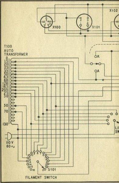

While restoring some of the stuff shown in the my Beauty of old electrical and measuring things etc. thread, I've measured 6 volt tube filament transformer supply voltages at 7.3 volts. This is because, like Jim says, our present day ac supply voltage is ~120 volts, while back then 110 volt was the standard. Also, the 6 volt tube filament transformers windings supplied 6.3 volts as the standard. Check out this old Philco tube tester supply transformer (primary = 110 volts, filament secondary = 6.3 volts):
Wiring schematic of a vintage tube tester with a T100 autotransformer tapped from 0 to 130 volts, a filament switch S101, tube sockets X100, X101 and X102, and a 110 V 60 cycle supply.
I've also noticed that some "old stuff transformer" voltages were specified while fully loaded.
So your transformer is good and you should have a bunch of lamps on hand ... :devil:
