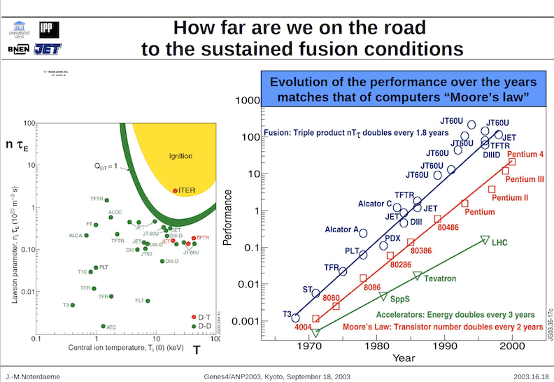

The issue is not that the required value for the Lawson criterion has moved. The issue is that it's taken a lot longer than originally thought to achieve the required value for the Lawson criterion.
This slide is old, but it shows the steady progress in increasing the triple product.
