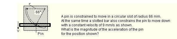

pls see the attachment. so pretty much magnitude of acc would be root (at2 + an2). i figured out an by subbing it into v2/p. but i can't figure out how to calculate at!
id really appreciate the help, I've been at it for 3 hours now! thanks!

ok let me show my working:
normal acc = 0.009^2/0.066
tangential acc i tried this:
s=r theta
s = 0.066 times (66/180)*pie
s = 0.07603
v = d/t
t = d/v
t = 0.07603/0.009
t= 8.4477 seconds
therefore acc = v/t
acc = 0.09/8.4477
then i squared this and the normal acc, but its not the right answer
