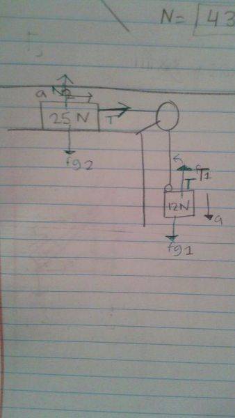

I have attached a picture of my free body diagram. But I don't know where to start after that. I am thrown off because the number in the boxes are not masses.
The numbers in the blocks are the weights of the blocks , w= mg. It is confusing when the problem is shown that way . But you can solve for m, then continue.
In order for the 12 N block to accelerate downward, does the tension in the string have to be greater than 12 N, less than 12 N, or equal to 12 N?

okay so m=w/g?
Yes
less than 12 N? Because If it is greater wouldn't it make it go upward?
Figure 2.
Yes. So that should give you your answer to part a.

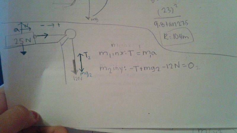

okay so I figured out the magnitude of the acceleration of the two blocks. I am a bit confused how to do part b. I have attached a picture of my FBD and equations. I would like to know if the second equation is right. If it is or is not equal to "0" since there is no mass. And if there is no mass it would also means there is no acceleration either.
Never mind the work I did for equation 2 I did above as noted in the photo. my m2 is instead T=-12N. I plugged that into the first equation and got -4.7m/s2. for my first value I got 3.2 m/s2. would part b be less than ?
To get the answer to part b, all you need to do is compare the acceleration for part c with the acceleration for part a.
