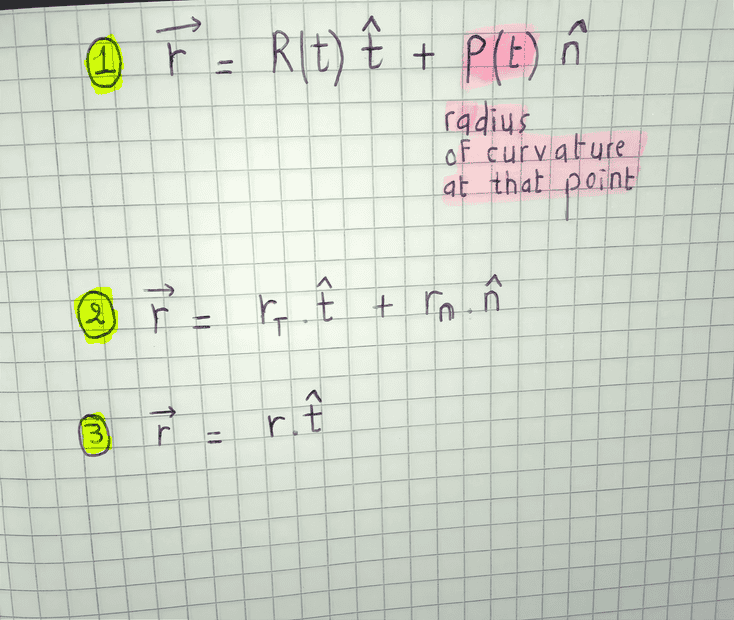

First question:​
Does the position vector exist in the tangential and normal coordinate system in curvilinear motion?
Regarding my teacher's response, he confirmed the existence of the position vector formula but was unable to provide it. Upon returning home, I attempted to find its formula.
However, I found three different answers from different sources, and I don't know which one is correct.
On the other hand, based on some sources from google , I found that :
No, the position vector does not exist in the tangential and normal coordinate system in curvilinear motion. because Normal-tangential (n-t) coordinates are attached to, and move with, a particle. Therefore there is no position vector in n-t coordinates. A typical n-t problem will either give the exact location of the particle on a path, or it will give kinematics information from which the position can be determined.

There may be some confusion between curvilinear motion and curvilinear coordinates.
The former just means the motion is not in straight lines, and is independent of the choice of coordinate system. That said, in some cases of curvilinear motion it may be more convenient to use curvilinear coordinates.
No. https://web.mst.edu/~reflori/be150/FloriNotes/ntCoordLectureNotes1.htm
Please provide links for the answers you found. I cannot make sense of (1) and (3). (2) is ok if it defines ##r_T## as the displacement from the origin in the direction of (current) ##\hat t## and ##r_n## as the displacement from the origin in the direction of (current) ##\hat n##, but that is trivially true and not at all helpful.

The first two formulas you provide for the position vector are correct (and the third too given that the normal component is always zero) BUT:
The position vector needs an origin in order to be defined and those formulas give the position vector with respect to the origin of another coordinate system that has a fixed origin. With respect to the origin of the n-t system the position vector is always ZERO!
So ultimately I ll have to agree with this quote of yours:
I cannot see that the first makes sense at all. What is #R(t)##, and what has the radius of curvature to do with it?
I gave an interpretation in which the second could be correct (but unhelpful). Are you using the same interpretation? If not, what?
Each of the equations could happen to be true in some specific context, such as a straight line trajectory for the third one, but surely what the OP is asking for is a general formula.
It is correct but the math are not so obvious ##R(t)## is the total arc length (or the length of the trajectory curve).. You can get this expression by considering the vector integral $$\vec{r}=\int \vec{v}dt=\int v(t)\hat e_t dt$$ where ##v(t)## the speed of the particle and doing integration by factors for ##v(t)=\frac{dR(t)}{dt}##. The radius of curvature comes into play by considering the $$\int R(t)\frac{d\hat e_t}{dt} dt$$ which is not always zero.
EDIT: Unlucky I overloaded symbol t, it is both time and the symbol for the tangential component.

It was always that part that struck me as ludicrous. How could the instantaneous radius of curvature at the endpoint be relevant?
@srnixo , where did you find (1)?
You got me in a bad time , its early morning, my sleep disease is at a peak today and did very bad sleep, it seems that that integral is equal $$\int \frac{R\dot R}{\rho} \hat e_n dt$$ but I see no way of proceeding further, maybe later if I manage to feel a bit better, if we do integration by factors again it seems to give a term $$\frac{R^2}{\rho}\hat e_n$$ but it gives another term too which I find difficulty to prove that it is zero, maybe later today when my mind becomes more clear.
It seems to be relevant cause of that term at post#15 but for sure not in the way the OP claims.
Maybe he did some sort of understanding error when he was reading the page, and that ##\rho(t)## is in fact something else.
I found it on a website in Arabic, as far as I remember. they said that: R(t) represents the radius of curvature in tangent direction and P(T) is the radius of curvature in the normal direction at that point.
so that the equation (1) provides a vector that accurately describes the position and curvature of the object at any point along the curved path.
and they said also that the equation (1) is similar to (2) but uses different notations. 🤷‍♀️

@srnixo Can you give us more detail on how they define ##R## the radius of curvature in the tangent direction. I got a hunch though I think it is defined so that $$v\hat e_t=R \frac{d \hat e_n}{dt}$$
For a curve (not a surface) there is only one radius of curvature at a point. I have no idea what "radius of curvature in tangent direction" means.
In 3D it gets more interesting. I did wonder whether the Arabic link related to that.
I use s for distance along the curve. All derivatives are wrt s.
If the position vector from some arbitrary origin is ##\vec r## then the unit tangent vector is ##\hat t=\vec r'##. If ##\hat t'## is nonzero at a point then the curvature there is ##\kappa=|\hat t'|##. The radius of curvature is ##\rho=1/\kappa##.
The principal normal unit vector is ##\hat n=\hat t'\rho##.
The plane containing those two unit vectors is called the osculating plane. As we progress along the curve, the osculating plane can rotate about the tangent.
The "binormal" is normal to both the tangent and the principal normal, ##\hat b=\hat t\times\hat n##, and so is normal to the osculating plane.
##\hat b'## is necessarily parallel to ##\hat n##, so we can define the rate of rotation, or "torsion", by ##\hat b'=\tau\hat n##.
But this does not correspond to any radius that I can envision.

However we can find an expression $$\vec{r}=R(t) \hat e_t+\rho(t) \hat e_n$$ that gives the position vector not in the n-t coordinate system (though it is expressed with the unit tangential and normal vectors ##\hat e_t,\hat e_n##) but this expression is the position vector in any coordinate system where we take as FIXED origin the point where the particles lies at t=0. Of course the unit tangential and normal vectors have to be expressed as functions of the chosen coordinate's system unit vectors. If the chosen coordinate system is cartesian and we know the trajectory as ##y=f(x)## then there are well known expressions that give ##\hat e_t## and ##\hat e_n## as expressions that include the function f and the cartesian unit vectors i,j.
Could you Mr @Delta2 clarify for me something!
Is this formula (equation1) which you provided only used when the object is at rest in the origin or moving along a curved path? In other words, It should not be used when the object is in motion?
the formula $$\vec{r}=R(t)\hat e_t+\rho(t)\hat e_n$$ can be used for any t, that is even the object is moving, it is just that due to FIXED origin requirement it doesn't give us the position vector in n-t coordinate system, though the expression is such that it might trick us that it does so.
  • Care
Alright, Thank you so much for your efforts. This is so helpful.
