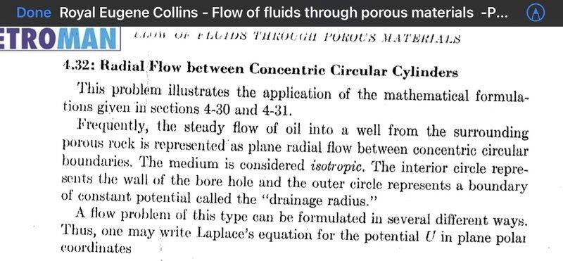

The R.E. Collins book carries a specific double cylinder permeability derivation that looks spot on. (Hat tip to Baluncore for the connection!)
After a first read through, I will have to back up two sections to get the context and variable definitions to try to gel the equations down to a practical unit calculations.
This read brings back great memories of Dr. Raymond Bell, Ace Calc III prof from 1972 e-school, cleaning our 20 year old clocks. (Jeez, has it been 50 years?)
Collins is also two+ pay grades above my mathematics ability and is fascinated at the elegant orthogonality between concentric, constant flow contours and radial, equal pressure gradients … more than calculating the real world, down hole parameters LOL … but now I think I’ve got a shot to get there.

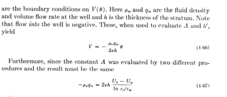

Ultimately, I need to move expeditiously to develop an equation that represents the dependent radial pressure profile variable as a function of the independent radius variable from the wellbore boundary condition of 30 psig. I have been fortunate to have come in possession of the well logs so there may be the possibility of closely estimating porosity and permeability.
The other boundary condition is taken from the reasonable assumption that at the r sub e ‘drainage’ radius, the pressure equals 45 psig, as that was the wellbore pressure before flow began from the well (as it had 15-25 years of zero flow and it was highly probable that the wellbore pressure equalized to the overall strata pressure.)
The pivotal value of the data here is to get a real handle on the r sub e distance to see if it is ~60 feet (very good) or ~5000 feet (very bad).
My difficulty is seeing a process to map detailed gas parameters like supercompressibility, etc into a form I can have some internal confidence that it is reasonably accurate.

I strongly suggest you enlist the help of a consultant on this. Regarding to ##r_e##, in a transient problem like this, it is going to be increasing with time (depending on the hydraulic diffusivity). The problem is probably going to require numerical solution.
