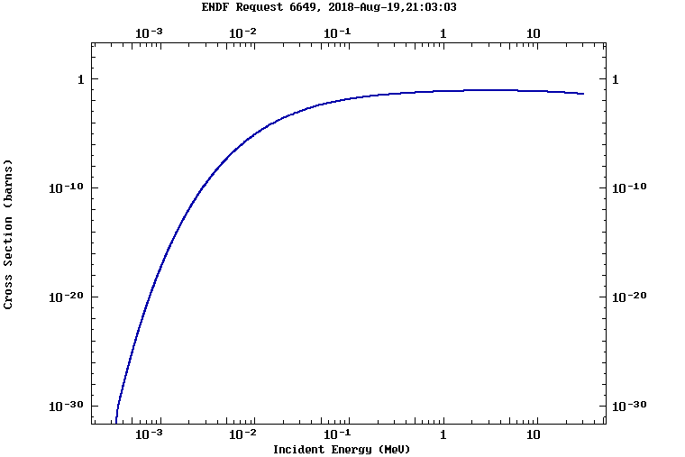

Hi,
I have been searching d-d reaction cross-section at higher energies up to 10 MeV. I checked ENDF database, however, I could not find any data. Do anyone offer a source from which I can get d-d cross-section data?
thanks in advance.

I believe it has been published, e.g., Thomas J Dolan's text, Fusion Research, Volume I: Principles
Professor Ragheb has a plot and some data in the following (see Figure 2):
http://mragheb.com/NPRE 402 ME 405 Nuclear Power Engineering/Fusion Concepts.pdf

Thank you for the source. I am not going to use this data for power related purpose, rather I am going to need it for neutron yield calculation. By the way, you mentioned the yield. Did you mean the net energy yield?
The ENDF is a very complete library, but in the future try using this part of their site for more detailed information than what you find on the main landing page:
https://www-nds.iaea.org/exfor/e4explorer.htm

I just realized I posted the wrong data set (must have been spending too much time on their site that day), this is what you are looking for if interested in the D+D->t+p cross section:
and this one for the D+D->He3+n cross sections:
Try the site out for yourself, it is very useful and full of information when it is working properly.
