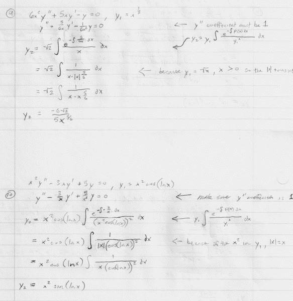

So going on that concept, are these two answers correct?
Handwritten reduction of order work on lined paper for two differential equations, problems 9 and 10, showing the second solutions y2 = -√2(-6-√2)/(5x^(3/2)) style integral steps and y2 = x^2 sin(ln x).
For 9: The actual integration is correct, however, your formula is wrong as you are multiplying by √2 instead of √x (y1).
Number 10 should be correct. Not quite sure how you deduced the integral was equal to x2sin(lnx) but it is correct.
Thanks. I fixed #9. For #10 I just used the Ti-nSpire CAS.

AH okay then. But for other integrals just make sure you can do them by hand if you ever need to.
Also when you are putting together your general solution, you can combine the constants so if you have y=c1x+25c2x2, you can rewrite it as y=c1x+c3x2.
