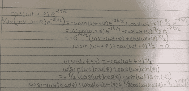

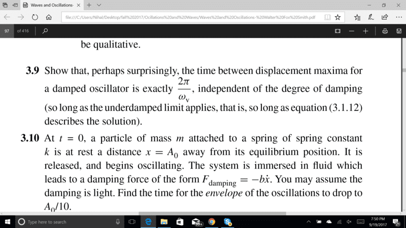

Question 3.9
equation for dampened ocillation[/B]
In case this might appear confusing, I derived(with respect to t) the equation for dampened oscillation given above and tried to solve for when it equaled zero expecting this to happen for periodic values of t.
The constant A is removed in my derivation because it is unnecessary to find the maximum points.
I got stuck when trying to solve the derived equation for zero and I do not think I am heading in the right direction. I would greatly appreciate any any all help.
Thank you in advance.

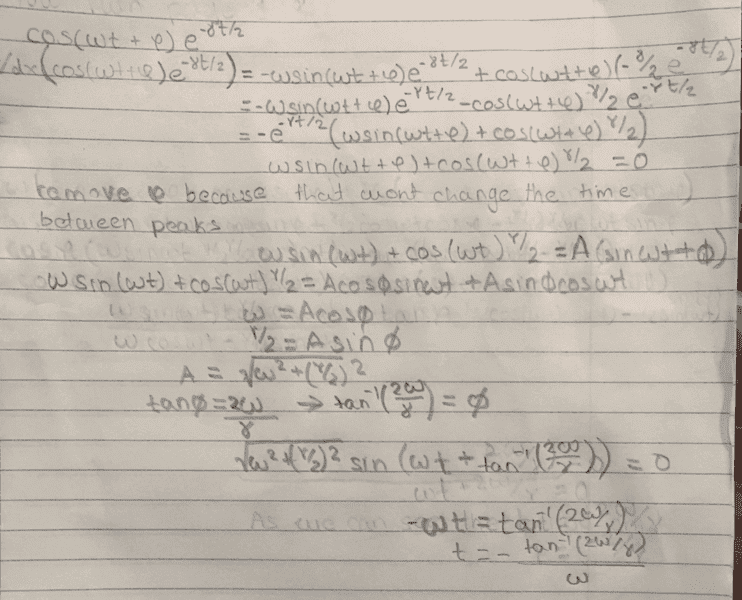

My attempt at a solution did not show up. Here it is
You can also get rid of phi as that is just a phase shift and does not change the period between maxima. That may help you figure out what you need to do next.

I tried to take what both of you said into account and it seemed to work. I was able to solve for t but it is not what I expected as is seems to still depend on the dampening constant ##\Upsilon##. Did I make a mistake somewhere?
