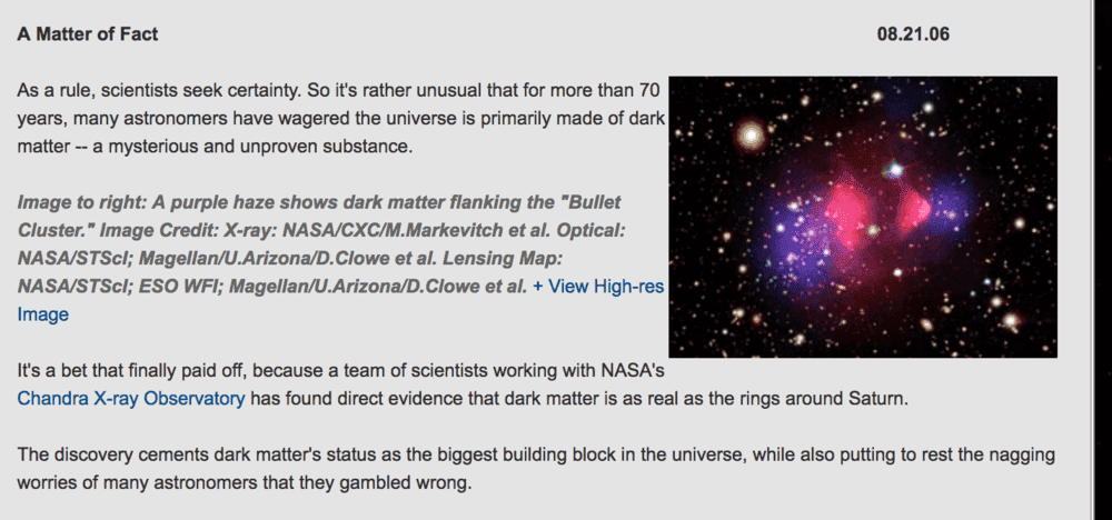

Here's the link:
https://www.nasa.gov/vision/universe/starsgalaxies/dark_matter_proven.html
Chandra's detector receives high energy photons, below claimed to be "purple" in hue. Photons aren't DM. Perhaps I've misinterpreted the text.

The purple bits to the left and right show DM distribution - it's the lensing map mentioned in the description. The x-ray emission from gas are in red, in the centre.

If you had provided the link from the beginning, we would not have had to guess. Yes, that is the Bullet Cluster. No, the x-rays are not from dark matter. Rather, the entire point is that the mass distribution inferred from gravitational lensing (purple) does not match up with the x-ray emitting gas (pink).

"A purple haze shows DM flanking the Bullet Cluster".
The caption's intended impression remains that the "purple haze" is DM.
I provided the link on page 5 at the beginning.
Meanwhile, here is an excerpt clarifying the Clowe, et al finding:
Clowe et al:DM.png
Clowe et al:A Direct Empirical Proof of...Dark Matter.png
The original link left the incorrect impression that DM was directly imaged as a flanking "purple haze"[1st link].
Clowe et al shows immediatly above that DM was subject to "weak lensing", while the hot red-orange baryonic "plasma distribution" was subject to strong lensing and spilt, to 8 sigma. The essentially spherical bluish "halo" is the (mostly unlensed) spherical DM. It's DM because it's mostly unlensed and didn't react as baryonic plasma.
Lesson: Don't accept an interpretation when you have the original.

The purple is not an x ray image. It is a mass distribution inferred from gravitational lensing. The x ray image is shown in pink.
This is why you should not read popularised science for any purpose other than entertainment.
No. DM is the source of the weak lensing of the background galaxies. Not what is being subjected to gravitational lensing.
No. The baryonic matter collided, giving rise to x ray emissions.
Also, don’t misrepresent the original.

Confusion stemmed from an official NASA release by a writer with the Chandra group who is much closer to the topic than I.
Your view is correct. I have discarded the popular DM misperception that DM can be seen and more carefully reread Clowe et al to fully agree with all points of your critique. As an admitted newbie I had no intention of misrepresenting anything.
My initial DM query was simply to ask "What exactly are observers seeing when they detect DM"?
Do you have any problems with this answer?
What is seen with recent x-ray studies is an advancing, post collisional hot plasma bow shock wave consistent with being gravitationally dragged through an invisible, resistant, fluid-like substance whose presence is consistent with DM theory.
  • #115
No, this is still incorrect. The x-ray image of colliding plasma has nothing to do with being dragged through DM or any resistance it may pose, gravitational or otherwise. By itself, it does not show DM in any sense.
In the Bullet cluster one observes two clusters of galaxies, which as per the traditional theory of galaxy structure should have two components accounting for its mass - the stars, and the interstellar+intergalactic gas. The majority of the mass should be in the gas component.

  • #116
The gas in either aggregation collides with the gas in the other (while the stars pass through), creating the x-ray image captured by Chandra's x-ray detectors, and showing the gas to have separated from the optically luminous stellar component.
This is expected regardless of any DM content and there's nothing in the paper about DM affecting the way the gas has separated.
The additional - and completely separate from x-ray detection - observation that allows DM to be inferred is the map of gravitational lensing, that shows where most of the mass in the colliding clusters is concentrated. In the no-DM paradigm, the lensing map should show the majority of the mass to be where the gas is.
Since the map shows the mass to be mostly where the stars are, not where the gas is, one can infer that there is some additional mass component, which is - like stars and unlike gas - collisionless, and - unlike stars or gas - invisible.
That's why the image credit in the bit cited in post #109 lists all those different observations. It's wrong to pick the x-ray one and say it shows DM. If anything, it's the lensing map that is the closest to 'showing' DM, since it tracks the gravitational signature.
Let me take another attempt to answer my 1st query: "What exactly are observers seeing when they detect DM"?
(1) Galactic baryons showing anomalously high relative speed infers DM. (Normal stellar velocities were recently asserted to reveal an absence of DM)
(2) Detectable gas displaced from galactic stellar components infers DM. (This is the 2nd sentence and 1st assertion in the Clowe, et al paper) The definitial problem is widely varying detectable gas morphologies.
If it's possible to make this answer simpler I'll be happy to keep listening.
