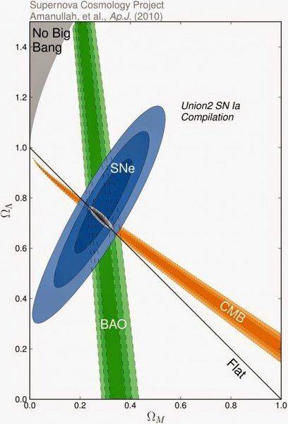

One way to see this is that the coasting cosmology is a universe where ##\Omega_m = \Omega_\Lambda = 0##. Below is a plot of the constraints on ##\Omega_m##, ##\Omega_\Lambda## from a few important data sets (attached, source).
The origin at the bottom left represents the coasting cosmology. Note that it's reasonably far from the supernova contour, but not ridiculously so. The BAO contour is an estimate of how much mass there is, and since in a coasting cosmology the amount of mass doesn't matter, it can be ignored for the purpose of this discussion.
The orange contour is the one I'm talking about: the CMB. The CMB contour doesn't come anywhere near the origin. I'd have to dig into the numbers to be sure, but it's easily dozens of standard deviations away. There just isn't any way to reconcile this.
