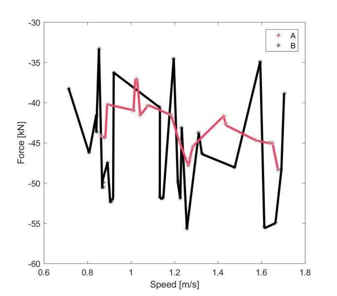

Hi all,
I have few measurements of a tillage machine running two types of soil engaging tools in terms of geometry (named A and B, respectively). I have measured the draft for running the machine and the speed. My aim is to analyse how much is the difference of the two tools in terms of force or power.
Below you can see a sample plot of the test.
https://i.postimg.cc/0QZYBYgj/untitled.jpg
As you can see, the data are rather scattered and I having some difficulties in drawing some conclusions. We can speculate, that A tends to lead higher force than B, but I am not fully sure, because I cannot assume the right regression curve. Probably, there are few outliers, which I cannot identify without assuming the regression curve.
What could I do? Any suggestion is appreciated.

It looks like all noise and no data, as if something very wrong happened with your experiment.

In case it helps, here is a rough graph of the data.
NOTE that the Red is roughly ±15% of nominal and the Black is roughly ±25% of nominal; both trending to decrease with speed. Perhaps they float a bit with increasing speed. (not unusual with farm equipment being towed) Or if this is drawbar force, the inertia of the tiller could account for the force decreasing with speed.
For experiment verification, try it in a bed of dry sand or a well plowed field.

You could do some statistical analysis, but I think that the data you show will not allow you do draw a conclusion at any confidence level about any difference in the average or in the trend. You may be able to draw a conclusion about the variation of the data, since the spread of the B data seems so much greater than the spread of the A data.
I am clarifying the data analysis
Here, I have a draft data https://i.postimg.cc/MKXgRjGb/untitled2.jpg. The measurements were carried out on steady conditions and the acquisition started and ended with a still tractor (that is the reason because the draft is almost 0kN at the beginning and the end of the acquisition. The plot reported is a repetition of a testing condition. The red part, is the part that I have selected for the analysis and from where, I have calculated the average value. I have a similar plot for the speed with its red part, from where I have calculated the average value as well.
Then, I have made a crossplot of the average value of draft with data and I get the following plot.
https://i.postimg.cc/CKfkCSfv/untitled.jpg
Now the data is positive, because I have plot the absolute value of the draft. Moreover, the plot is a bit less scattered, because the steady part was not perfectly selected in the previous script.

The fact the dract is constant/decreasing with the speed is weird, since from the theory it should quadratically increase.
You're on right that the implement may float with the speed, but I thinkt, that is not the case. Here you can see the working depth with the speed.
https://i.postimg.cc/ZKMmkSCF/untitled3.jpg
As you can see, it is almost constant. The little difference could be caused by a little different setup in the measurements.

Why? The draft is low at the beginning and the end of the acquisition because the tractor is still and the implement is out of the soil.
After doing linear regressions (separately for A and B), there remain residual errors (see http://www.statisticshowto.com/residual/ ), which are the differences between the actual data velues and the predictions from the regression equations. Most statistics regression programs will report the residual standard deviation (see https://stat.ethz.ch/R-manual/R-devel/library/stats/html/sigma.html ). The statistical properties of the residual standard error are mixed with the statistical properties of the regression line coefficients, since they are also estimates and not true values. But your case displays so much difference in sets A and B that I think it will be statistically significant.
PS. I am not experienced enough to give advice on how to handle data with sets of different varience magnitudes. Maybe someone more expert can help here. I have reached my knowledge limit.
I'm a little confused. One plot is force vs. time and appears well behaved. Another is force vs. speed and appears to be pure noise. Who are you converting from on to the other? Are you recording your speed separately and pulling out chunks of that F vs. t graph? Do you have multiple F vs. t at different speeds?

Is it just me...The magnitude of the force appears to increase with speed as expected. Normally a negative sign indicates the direction.

Is it possible the depth of the tool wasn't consistent? I'm surprised you are getting such large variation even after averaging 6 runs. What's the variation like run to run at same speed?
serbring said:
I have the time based force and speed acquired in the same moment. Tests were carried at different target speeds , which were 0.8m/s, 1.2m/s and 1.6m/s. The plot that report, the force vs. speed is the plot of the average value of the time based force vs. the average value of the time based speed. The average values were calculated in the the red part of the time based force, that is the only part where the tool was into the ground and were the tractor reached the target speeds, which were 0.8m/s, 1.2m/s and 1.6m/s
The force vs. time plots you showed appeared to be pretty good. It has some scatter, but is otherwise pretty good. It clearly has some meaningful frequency content as well.
Do your speed vs. time data look similarly good?
Based on the plots you showed with the depth, I have a strong suspicion that is what is causing your scatter. You could look at the correlation function between the depth and the force as well as between the speed and the force and try to prove which one is the dominant factor. You are basically treating this system like it has only one independent variable (speed), but it seems like you are ignoring a second independent variable (depth) that is poorly controlled, and the uncertainty from that variable is propagating into your dependent variable (force) and totally washing out the information you truly want, which is force vs. speed.
Make a 3D plot of force as a function of speed and depth. I'd be willing to bet the data look much more organized.

Here we go for speed and depth both vs. time.
https://i.postimg.cc/D0DnZpTp/untitled5.jpg
The speed is quite unsteady, because the test was carried out with a constant working depth, so the draft control was disabled. However, on the tractor, there is A single effect hydraulic cylinder, so there might be a variability.
the phenomen is clearly a bivariate one, but I admit I am not experienced enough for effectively analyse bivariate data.

Good guess! B tool is equal the A tool but it was worn out after a year of usage. The data was acquired at the same instant. Do you have any reference material about the variability caused by the wear?

Clearly the uncertainty from your depth is the big factor here. That looks like roughly +/- 50% variability on the mean.

Well, obviously there isn't much use without being able to rotate it and look at it. You could fit a least-squares surface to the data and see how well that works.

From that plot you can see that the force is much more strongly correlated with depth than with speed, at least over the rage of variation in the two that your data experiences. Your scatter is almost certainly due to scatter in the depth.

Cross correlations are normalized. So the scale and units of a variable does not matter.
I have used Matlab and the default option is to not normalize the cross correlation.
"By default, xcorr computes raw correlations with no normalization" (https://it.mathworks.com/help/signal/ref/xcorr.html#bual1fd-scaleopt).
By using the option 'coeff' for "scaleopt" (it means, that normalizes the sequence so that the autocorrelations at zero lag equal 1), I have got the following plot: https://i.postimg.cc/qB9WpJm0/xcorr_norm.jpg.
and, for this dataset, the speed is more affected by draft than depth. The difference between the two peaks seems to be small in my opinion. By runninng the calculation on different datasets, sometimes cross correlation with respect to depth is larger than that with speed. But the results are quite variable.
