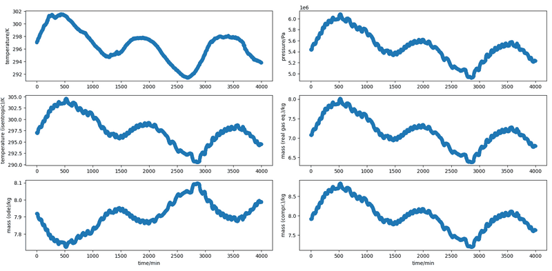

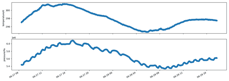

Leopold89 said:
Sorry about the x-axis. I wrote that measurements take place every 2 minutes, so I got lazy and omitted the x-axis. The first row is direct sensor data for temperature and pressure. The x axis is the same for all plots, which is why I now only wrote it at the bottom.
The jagginess is only observable in CO##_2## and not in any other gas, but you see the same jagginess in all two CO##_2## tanks. That is why I think a defect or noise is unlikely, but on the other hand the other gases do not show this pattern. The slow rising pressure is, as far as I understand, the result of weather. Guessing the discharges might be difficult, because small amounts of this one gas are discharged.
The jagginess might also be only of secondary concern, because if the mass is calculated correctly, you should be able to smoothen this pattern away.
OK. So the long-term trends could be influenced by the weather. Would it be possible to plot this with a timestamp (e.g., day, hour, minute, or just day and hour)?
It would be feasible if you know the time at each time step, or you could assume the peak temperature represents the hottest time of day to see if that provides a clear pattern.
It might also help to understand how heat is transferred to the tank. For instance, I'd expect the tank temperature to rise around 15:00 when the room temperature is highest.
In addition to the temperature sensor you've mentioned, do you have another one to monitor the room from which the tank is absorbing heat?
However, those sudden pressure increments don't make sense. I can't figure out what's causing them. I could understand sudden drops in pressure if you're opening the valves to release pressure, but not the opposite. And even that should not cause such jaggedness since you mentioned that the valves only open a couple of times a day.
Can you find out how long the valves remain open? Is it a matter of seconds, minutes, or hours? You said they release small amounts, but I want to see if these releases could overlap with the long-term trends we're attributing to the weather.
Finally, can you share your pressure and temperature (P and T) data from the last plot in the same format you previously used to share the saturation bell for CO2? Ideally, with the timestamp included as well.

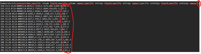

Leopold89 said:
For the bell check I used this CO##_2## table attached here and interpolated it with scipy.interpolate. This way I get a pressure for a given temperature and can check if the measurements are below this limit. If not the program aborts.
So you might release some mass at the beginning when the tank is full but you won't release any mass in future days because the heat input from the room won't be enough to increase the pressure to the point to force the valve opening again now that there is less mass inside. This is unless the next day is significantly hotter than the previous day.

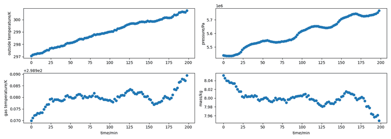

Let’s see what you get if you plot the measured outside temperature at time t as a function of the measured inside pressure at time t.
In above plot I believe to see how the temperature is maximal between 12:00 and 16:00, but the pressure is maximal at around 16:00, maybe a little later than the temperature.

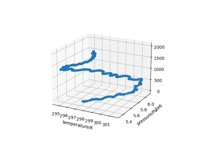

Did you mean something like this? The z-axis is still time in minutes though.

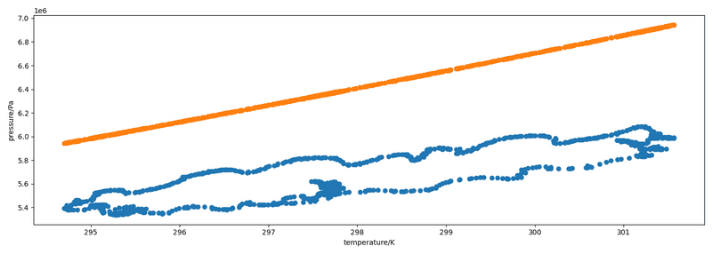

I switched the axes, because it fits better with the phase diagrams I know. Orange is the interpolated vapour-liquid-limit from my table.

  • #97
Leopold89 said:
For the bell check I used this CO##_2## table attached (...)
What's the meaning of ##r##?
I think I don't need it for the way I want to solve it but I'd like to know.
This graph seems to suggest that, since the pressure is less than the equilibrium vapor pressure at each temperature, the gas is always superheated. That would mean that there is a single phase at all times. (I assume you have plotted the absolute pressures, not the gauge pressures, which are 0.1 MPa lower). Under these circumstances, the equation of state indicated by Juanda applies: $$\frac{m}{V}=\frac{PM}{zRT}$$where m is in grams, and R=8.314 J/mole-K. So you can calculate how m varies with time in your example (assuming the temperature in the tank has equilibrated with the outside temperature at each time). What do you calculate?
Oh, no. I plotted the gauge pressures. The absolute pressures are only in post #71.
I calculate precisely this in post #88. It is the bottom right graph.

That could change the problem significantly. I did everything assuming we're talking about absolute pressures.
If that's true, then all I can think of is two things:
  • either the new data regarding absolute pressures changes the problem significantly because you're inside the bell although you mentioned you're checking if that's the case and it seems it's gas all the time
  • or your sensors are not accurate.
My bet is that your temperature sensor is not accurate to describe the gas' temperature since it's not inside the tank. Could you at least attach it to an outside wall of the tank and cover it with an insulating paste of some kind?
However, it's also true that the jaggedness is introduced by the pressure sensor... I really don't know what's going on and I'm running out of ideas.
Maybe some sort of resonance between the springs in the valve and the compressed gas? I'd be very surprised it's not dissipated quickly and also the period is too long. I'm throwing ideas to the wall and seeing what sticks at this point.
By the way, I didn't know you already tried my approach on post #88 so I did it too although I'm using the values from #73 where I assumed we're talking about absolute pressures.
In theory, the problem should be doable just with Pyromat because you can get the specific volume from the pressure and temperature but I got a different result compared to what was done in #73. I guess I'm not experienced enough with that library and I'm committing a mistake. I calculated the mass again using the gascompressibility library to find ##Z## (after a few awful unit conversions) and then I did get the same results as in post #73.
So the red one is the one I trust for now. I can't find what I did wrong with Pyromat because I told it to use the SI units.

  • #108
I have now finally completed the computation with the new model by Chestermiller. As I could not find a clever substitution to separate this differential equation into two separate, I instead implemented this equation as minimization problem with the mass and temperature time serieses as optimization variables. This had the unfortunate consequence that I could not compute the change over a whole day in a timely fashion. Now I had to reduce the time series to the first 200 minutes. Over the next days I will also try to complete the rest of the day.
  • #109
But you're still seeing mass increments. Although the overall trend seems more realistic than previous results.
Maybe the sensors are not measuring correctly sometimes when things are happening too fast.
  • #110
Maybe it is not that realistic, because the gas temperature is essentially constant compared to room temperature, but the gauge pressure still rises, likely even more than justified, if you look at the plot in post #71. But I also had to adapt Chestermiller's formula a bit, because I do not have liquid phase under these conditions. I started with ##U=mu_V \Rightarrow \mathrm{d} U = m\mathrm{d}u_V + u_V\mathrm{d}m## and inserted it into ##\mathrm{d}U=h_V\mathrm{d}m - \alpha A\Delta T## and got ##m(\frac{\mathrm{d}u}{\mathrm{d} p} \dot p + \frac{\mathrm{d}u}{\mathrm{d}T}\dot T) + \alpha A(\dot T - \dot T_s) = (h-u)\dot m##. Maybe my derivation is wrong.
