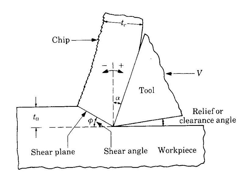

This approach is incomplete. The acceleration force on the slide and tool holder is most likely much larger than the cutting force. A rough estimate of the cutting force is the cutting area times the yield strength of the material. The cutting area is ##t_0## times the cut width (distance into the screen) in the figure below.
The kinematics calculations will give the slide acceleration vs crankshaft position. The point of peak acceleration is not necessarily the point of peak stress in the red arm, so do some checking there. A full analysis will check the stresses in the entire red arm over a range of crankshaft positions because the point of peak stress is not obvious. Also bearing loads, stresses, and sliding velocity (for PV calculations).
The figure is from Manufacturing Processes for Engineering Materials by Serope Kalpakjian, first edition. This book is currently in its sixth edition: https://www.amazon.com/dp/0134290550/?tag=pfamazon01-20. Highly recommended for usability and readability.
