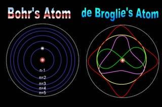

I know Bohr model is already obsolete. Here the first orbital corresponds to 1 (h/2pi), 2nd orbital is 2*(h/2pi), 3rd is 3*(h/2pi) and so on where larger orbitals have larger angular momentum. deBroglie discovery of matter wave gives the 2pi the wavelength justification.
Now 90 years of Born probabilistic interpretations later. I think we no longer have to think higher orbitals have longer probability waves. But still Bohr postulate that higher energy electron occupies higher orbital is still valid, see for example http://www.astronomynotes.com/light/s8.htm
In our modern QED.. why does higher energy corresponds to higher orbital.. like when the photons have more energy, the wave functions become fatter? and it doesn't mean the energy of the photons is really located in higher orbitals.. only the wave function is fatter overall?
I think you should first get a good understanding of non-relativistic QT. Perhaps I shouldn't have started to also include QED in my arguments, although it's the most complete theory relevant for the atomic physics you seem to discuss.
The discrete energy levels of the hydrogen atom in the non-relativistic approximation have energy eigenvalues
$$E_n=-\frac{13.6 \; \text{eV}}{n},$$
where ##n \in \mathbb{N}=\{1,2,3,\ldots \}##. Each level is ##n^2## fold degenerate due to the high symmetry of the Kepler problem. The observed emission and absorption spectrum is given by differences of these energies, as was already found empirically by Balmer in the 19th century.
I don't know what you mean by "the wave functions become fatter". It's also not clear to which quantity you refer to when you talk about the "wave function of a photon". Despite some attempts to describe even photons with a wave function, that's a more or less ill defined concept since photons do not even admit a position observable in the usual sense. This somewhat shaky concept is completely absent from the standard formulation of QED.

A century ago. They thought of these orbital things because they either imagined like Bohr initially that the electrons were like planetary orbits. Or in the case of de Broglie.. they thought of it as actual waves around the atoms. So when you make atoms absorb photons.. the energy would still occupy next orbitals. But with our now probability interpretations. I don't think one can say the electron is stable in an orbital due to the probability waves.
Or when you make the atoms absorb energy. Why is there an electronic transition to higher orbital. There are now no orbits or de Broglie waves to make it transfer to higher orbital. And probability waves are not really there.. so what happens in electronic transition in our modern understanding?
We calculate transition probabilities. E.g., for absorption you can use the semiclassical theory, i.e., you consider an electromagnetic wave interacting with the atom and calculate with time-dependent perturbation theory the probability for transitions from one atom-energy eigenstate to another higher one. See my Insights article for the case of the photoelectric effect.

I read it. So these atom-energy eigenstate doesn't really correspond to lower and higher orbital of the electrons? in plain English, what cause the orbital to be higher or lower? or are these remnants of the ancient particle-wave duality thing by de Broglie, and the atoms just absorb and emit energy without the electrons actually in higher or lower orbital?
You can translate "orbital" with "state". If the atom is in an energy eigenstate, its energy has a determined value, implying that an eigenstate with a higher eigenvalue describes an atom at a higher energy.

This is what I wanted to know. So higher orbital doesn't mean the electrons are really in higher orbital? So these are all wrong?

Before 1927. The following is the idea of atoms.
After the Born probability interpretation. We have:
In all pictures in the internet. There are no longer standing waves present. But is the truth there is standing waves inside the probability cloud? like:
?? So although de Broglie standing waves were replaced with probability clouds.. the standing waves are still there, only you can know the location of the particle only by probability as per Born interpretation whereas de Broglie thought the entire standing wave is the particle (?)
(Is the above description accurate if I'd state it to laymen??)
Also someone please show me good drawing of a probability cloud (orbitals) with standing waves present inside. Thanks!
These are standing waves, as I've shown above.
Are they standing waves caused by the invisible Born probability waves or are they standing waves caused by the charges in the electron? Or standing waves caused by fields? What about particles without charges. Let's just focus on non relativistic none qft concepts meantime..thanks
I don't know, what's your problem and why you call probability waves "invisible". They are measurable and the probabilistic content is measured all the time.

Have you ever compared the mathematical description of a standing wave on e.g. a vibrating string with the mathematical description of a hydrogen orbital?
A standing wave (as opposed to a traveling wave) on a vibrating string can be described by an equation of the form ##y(x,t) = f(x)g(t)## e.g. ##y(x,t) = \cos(kx)\cos(\omega t)##.
##f(x)## gives the overall "envelope" or "shape" of the wave, which does not change with time. ##g(t)## gives an oscillating time-dependence which is the same for every point on the wave. The amplitude of the oscillation at each point x is ##f(x)##. The oscillations at all points are in step ("in phase") with each other.
[If you're not already acquainted with the above, I suggest you study standing waves in classical mechanics.]
The wave function for a single hydrogen orbital with quantum numbers n,l,m is ##\Psi_{nlm}(r,\theta,\phi,t) = \psi_{nlm}(r,\theta,\phi) e^{-i(E_n/\hbar)t}##.
##\psi_{nlm}(r,\theta,\phi)## gives the overall "envelope" or "shape" of the orbital, which does not change with time, and is analogous to ##f(x)## in the standing wave above. ##e^{-i(E_n/\hbar)t} = \cos[(E_n/\hbar)t] + i \sin[(E_n/\hbar)t]## gives an oscillating time-dependence which is the same for every point of the orbital. The amplitude of the oscillation at each point ##r,\theta,\phi## is ##\psi_{nlm}(r,\theta,\phi)##. The oscillations at all points are in step ("in phase") with each other.
This description is completely analogous with a standing wave on a string, except for the number of spatial dimensions and the use of complex numbers in the time-dependent part.
You can find tables of ##\psi_{nlm}## for different sets of quantum numbers, in many textbooks and on many web pages, e.g. here:
http://hyperphysics.phy-astr.gsu.edu/hbase/quantum/hydwf.html
So e.g. for the ground state (n,l,m = 1,0,0) we have $$\Psi_{100}(r,\theta,\phi) = \frac{1}{\sqrt{\pi} a_0^{3/2}} e^{-r/a_0} e^{-i(E_0/\hbar)t}$$ where ##a_0## is the Bohr radius and ##E_0## is the ground-state energy of hydrogen.
The pictures that you see in textbooks (like the ones you showed above) are an attempt to show the "shapes" of the probability distributions ##\left| \Psi_{nlm}(r,\theta,\phi,t) \right|^2 = \left| \psi_{nlm}(r,\theta,\phi) \right|^2##. They are analogous to pictures of the "envelope" of a standing wave on a string. To be complete, they should include some kind of "shading" or "fuzziness" to indicate the variations in probability density with position.
There are no smaller waves "hidden" inside these diagrams, as you attempted to draw in one of your diagrams. ##\Psi## at all points in an orbital oscillates together, in step with each other, according to the position-independent time dependence ##e^{-i(E_0/\hbar)t}##.
