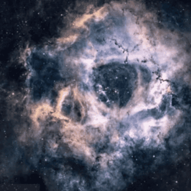

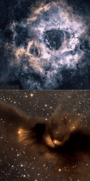

These images of the Skull and Bat Nebula are circulating:
I have called them both out as - not merely edited - but outright fake.
These are unfaked images of the two:
Unfortunately, in the case of the Bat Nebula, even reputable sources seem to be promulgating the lie.
News claiming NASA released it,
APOD,
even Snopes seems to have been duped.
I am looking for a definitive source, particularly for the Bat Nebula.

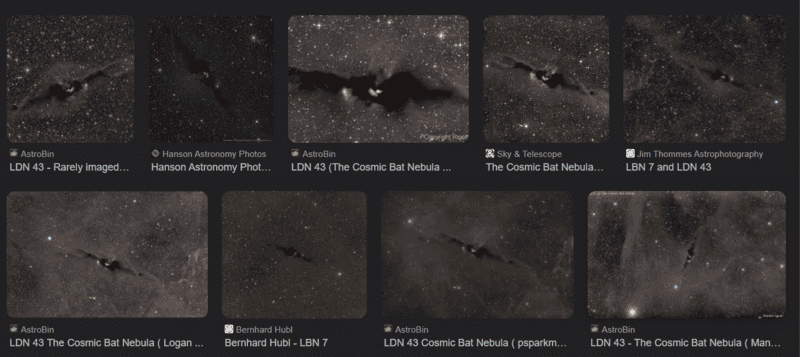

You might assert that but here is an image of the top 9 images of a quick Google search of LDN 43 (the "bat nebula"). Pretty batlike if you ask me and I'm not even sure if your "Official" one is of the same object since there is no data about the image.
Indeed. And as I have been arguing, trust only reputable sources. Internetters are doing the same thing you did. Google does not curate its results, and this image is being spread with zero comments about its veracity or its provenance.
Which is the very reason why I am asking for a definitive source.
Now if one of those bat-like images were found with associated metadata, I'd consider that confirmed.
DaveC426913 said:
Indeed. And as I have been arguing, trust only reputable sources. Google does not curate its results, and this image is being spread with zero comments about its veracity or its provenance.
No, no, no! Not indeed! Look at the sources of those images APOD, Sky & Telescope and a bunch of reputable amateur astronomers.

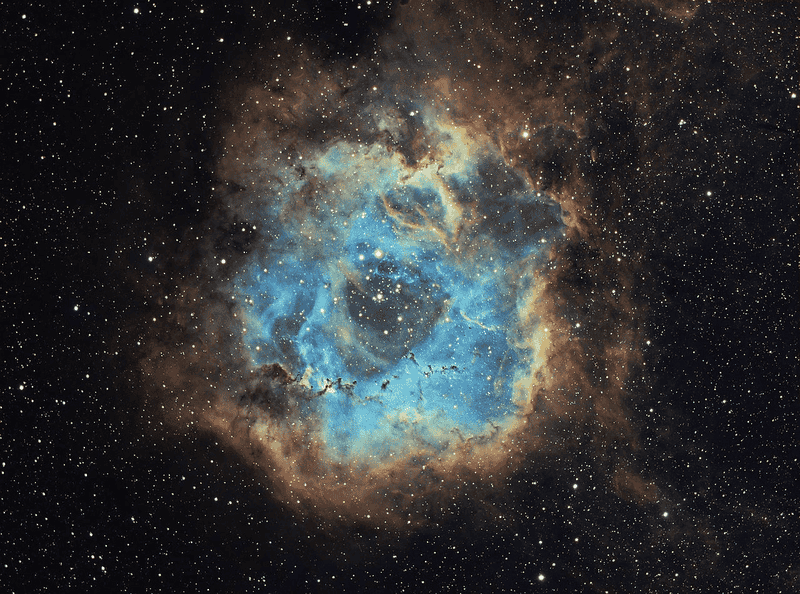

Also about the skull. After some searching it looks like that is NGC 2237, the Rosette Nebula which can, if you select your narrowband filters and palette in certain ways, indeed look like a skull (cool, did not know that).
Although the image in your example is badly processed there are very nice more subtle ones out there.
Surprisingly, of all the parts that I assumed were faked in, it is the nose and nasal septum that are really part of the nebula.

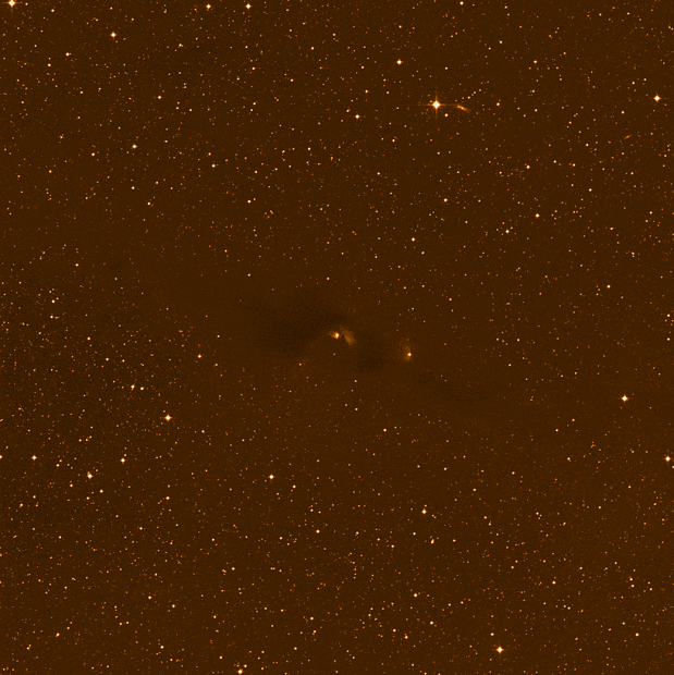

Maybe this will be enough to convince you:
I cannot link to the search but go to the European Southern Observatory - Digitized Sky Survey at
https://archive.eso.org/dss/dss
Set the object to LDN 43, image size to 45x45 arc minutes, survey to DSS-2 red, output to Display as gif and then imagine that the result is not a GIF of a short exposure in red with no processing but a nicely processed very long exposure in LRGB.
Should look like this.

Me: "They're all fake. It's viral. Here is the real image, and here's why I know it's real. (Me, reaching out to PF)"

Ok, so you think someone is wrong on the internet. I though we had (at least almost) established that the "skull" is a valid (if IMO probably stolen and badly processed)
"stolen and badly processed" in my books counts as fake.
glappkaeft said:
narrowband astrophoto representation of the Rosette nebula which would mean that everyone I have ever discussed this with in astrophotography circles would agree that the skull image is not fake.
The Skull Nebula is not fake. That image is. It's been heavily altered, by your own admission.

Also in other posts that the "bat" is real.
After finally finding that image of the Bat Nebula with acquistion data, there's no longer any doubt it's real

For what it's worth, Dave, after a little googling, I'd judge both to be real, but the first one (Skull/Rosetta nebula) may have significantly altered colors. Without finding the original source of that, it's tough to know how it was constructed though. But there are many amateur photos of that nebula showing that shape/detail.
The bat is a little more rare, but I found a site that looks like a "reputable amateur" as @glappkaeft called them.
Here's one of each:
https://www.cloudynights.com/topic/864747-the-cosmic-skull-aka-the-rosette-nebula/
https://www.astrobin.com/7z89it/E/
