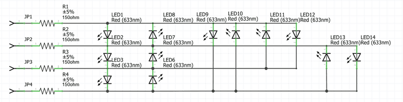

I am trying to create a circuit which can individually turn on and control 12 LEDs from 4 pins, since I am trying to adapt it to a tiny microcontroller (the Attiny85, which does not have enough pins to drive the LEDs)
For this, I am using a method called Charlieplexing. You can for example read about how it works on Wikipedia, which has a better explanation than what I can come up with. I have posted about this project in another thread, see here: https://www.physicsforums.com/threads/charlieplexing-leds-have-different-brightness.1078255
The schematics I am using can be found below, where JP1-4 are GPIOs on the microcontroller I will be using:

The "all LEDs on" assumption is impossible. Where in your calculations do you allow for the duty cycle of the LEDs?

Why do you multiply the LED current by 12, if only one is on at the time?
I would expect to find some way to increase the duty cycle to about 1/6 by considering some combination of on times, but I see no way to make it 1/1.
The "thermometer display" uses more power with LEDs, because many LEDs must be operated sometimes.
