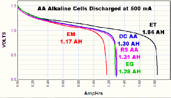

An AA alkaline battery stores 3.9 watt-hours of energy which is 14000 joules. An AAA aklaline battery stores about 5900 joules. I found those numbers with Google. You can do the same for other kinds of batteries.
However, not all of that energy is useful for motors because the voltage drops as the energy is used up. Below is a typical discharge curve for alkaline batteries. You need to find out the minimum voltage for those motors.
L
Is the rescue environment cold? If so, Lithium batteries perform better in cold temperatures than some other battery types.
Shelf life, size, weight, temperature range, rechargability, cost and other factors influence the choice of battery. You have not provided us many of your requirements.
