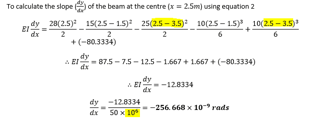

EI dy/dx=(28(2.5)^2)/2-(15(2.5-1.5)^2)/2-(25(2.5-3.5)^2)/2-(10(2.5-1.5)^3)/6+(10(2.5-3.5)^3)/6+(-80.3334)
∴EI dy/dx=87.5-7.5-12.5-1.667+1.667+(-80.3334)
∴EI dy/dx=-12.8334
dy/dx=(-12.8334)/(50×〖10〗^6 )=-256.668×〖10〗^(-9) rads

Ok, I got motivated enough to check your work. Your solution methodology is fine, and your calculations are correct up to the evaluation of the derivative on the last step. Check to see if values inside the parenthesis are negative before you include them in the sum, and your ##EI## is also converted incorrectly. You are looking for units of ##\frac{\text{kN}}{\text{m}^2}##, you have used ##\frac{\text{N}}{\text{m}^2}##.
You should be getting something in the vicinity (magnitude)of ## 2 \cdot 10^{-3} \text{rad}##...so you were correct...slope was too small.

Hello erobz,
Thank you for the clarification. While I did eventually manage to factor in the kN part of this equation into my final calculations, I did not exclude those two parts from the final equation.
My final answer was $$-0.000256668 rads$$
I have now submitted this assignment and cannot make any changes.
