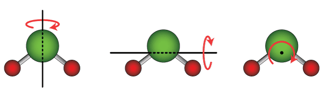

List all the degrees of freedom, or as many as you can, for a
molecule of water vapor. (Think carefully about the various ways in which the
molecule can vibrate.)
There is no.
Well, first of all is really good to say that we don't can appeal to quantum mechanics...
So, i can see:
Three degree of freedoms in translation on a space xyz +3 degree
Three normal modes of vibration, but each normal mode has with it a potential and vibrational kinetic energy, so +6 degree
The problem is rotation, how can i know what directions can i molecule rotation?

haruspex said:
Yes, but the two forms of energy do not constitute separate modes.
Wrt rotation, I believe water molecules are sufficiently nonlinear to be counted as having three rotational degrees of freedom.
The H-O bonds enclose 105 degrees, so the molecule is definitely nonlinear. The rotational modes are around three axes, two of them in the molecular plane and one perpendicular to it.
http://www.xaktly.com/Water.html
This is a really good image, so nonlinear molecules always has three degree wrt rotation?
Well, with this +3 deegre, we get 12, the answer...
yes.
