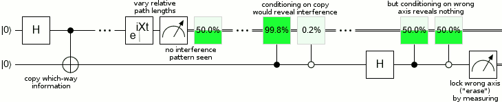

Here's a quantum circuit analogue of delayed choice:
Now consider: what's the state of the bottom qubit after the top qubit is measured, supposing that the rotation around the X axis was 45 degrees and that the measurement result was OFF?
Right, because of the entanglement, it's as if the second qubit started in the OFF state and was itself rotated around the X axis by 45 degrees. Specifically it's proportional to ##\cos(45^\circ) |0\rangle - i \sin(45^\circ) |1\rangle##.
In that state, when you measure the second qubit along the ##Z## axis, you'll get differing probabilities (##\approx 14.6##% chance of being ON). But, because the spin is lying on the YZ plane, there's no bias along the ##X## axis. There's a 50% chance of +X and a 50% chance of -X, if you measure along the X axis.
Now, apply Bayes rule to flip things so that instead of predicting the second qubit's measurement based on the first qubit's measurement, you're using the second qubit's measurement to predict the first qubit's measurement. Along the X axis the 50/50 results give you no predictive power. Along the Z axis, the deviation from 50/50 gives predictive power. Call the X axis measurement "erasing", and the Z axis measurement "not erasing".
If you then hit yourself in the head with a hammer, so that you forget that we're working with correlations instead of causation, and also forget the order things happened in, and also forget that we're conditioning on both qubits instead of just one in order to see anything that looks like interference, then it kinda looks like the second qubit's measurement retroactively determined whether the first qubit's measurement showed interference. How amazing :rolleyes:!

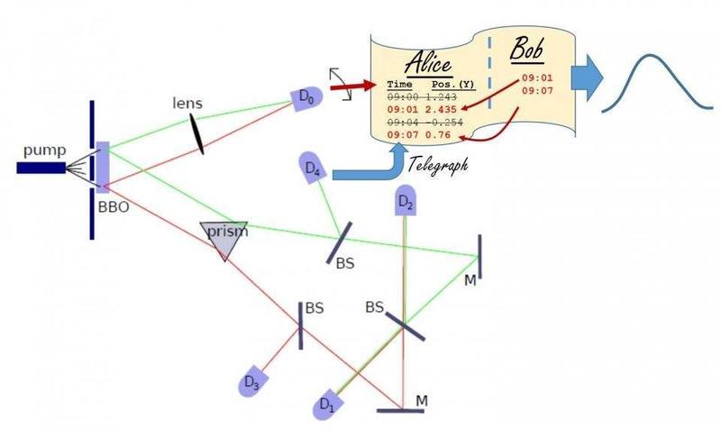

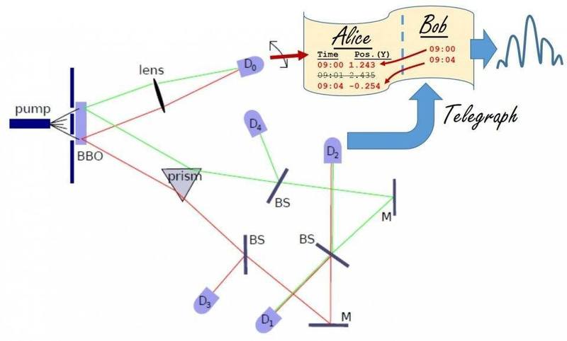

Sunrah, One thing that is not stressed heavily in Gaasbeek's paper (but is implied throughout) is that the interference only shows up when we match up "twin" photon pairs according to their arrival times, and plot the scatter diagram only for those photons on the screen whose twins go to D1 or D2. So we need to set up a telegraph that sends data from Bob to Alice for comparison and selection.
So I guess one could say, "If a photon happens to land on a null in the interference pattern at detector D0, then its twin will never go to D1 or D2 but will only go to D3 or D4. And if we reject / ignore all D3 and D4 events then we are left with those events where all the D0 photons have carefully avoided the nulls in the interference pattern, therefore this kind of plot will show interference". I have added some graphics to the figure in the paper:
On the other hand, photons that happen to land on interference nulls at D0 --> their twins will be going to D3 or D4 pretty often, so that this pattern will not reveal any nulls and peaks... like so:
Likes sunrah
Thanks, I think the DCQE has been slightly demystified now, but I'm still not really comfortable with it.
If Alice (D0) and Bob (D1,D2,D3,D4) do the experiment, and Alice's data represents a complete dataset, then Bob's data represents the key telling Alice how to read her data properly. (People will disagree with this I'm sure, but I think qualitatively it's not a bad way to explain the behaviour at D0). The information containing fringe patterns must really be there, yet without knowledge of Bob's data, Alice won't be able to extract it. According to this paper: http://arxiv.org/pdf/1009.2404v2, a single-maximum curve will be observed, even if Bob doesn't bother to measure which-path information, i.e. too lazy to set up detectors Di where 0<i<5. This suggests to me that wave function collapse of both photons is not necessary to already deviate from a classic double slit experiment.
