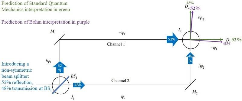

Experiment
Could there be any way to alter the Mach–Zehnder interferometer to distinguish between the two interpretations? Perhaps if the one beam splitter was non-symmetrical, let's say reflecting 52% of the time and transmitting 48% of the time (52-48) rather than 50-50, differences may emerge for the results predicted by the two interpretations.
Predictions are illustrated here with a Mach–Zehnder interferometer in "particle mode" with a non-symmetrical beam splitter:
This is a modified version of Figure 2 from the paper.
Blue highlights my modification to the interferometer.
Green highlights the predictions of the Standard Quantum Mechanics interpretation.
Purple highlights the predictions of the Bohm interpretation.
In the Standard Quantum Mechanics interpretation, the 52% of photons reflected at BS1 should reflect off M1 and arrive at detector D1. The 48% of photons transmitted at BS1 should reflect off M2 and arrive at detector D2.
In the Bohm interpretation, the 52% of photons reflected at BS1, traveling with a stronger quantum potential, should reflect off M1, enter region I2, 'bounce off' the weaker quantum potential arriving from the lower path, then head towards D2 at an angle bent slightly towards D1. The 48% of photons transmitted at BS1, traveling with a weaker quantum potential, should reflect off M2, enter region I2, 'bounce off' the stronger quantum potential arriving from the upper path, then head towards D1 at an angle bent slightly towards M2.
If one could gradually increase the reflectivity of BS1 from 50% to 100%, the number of photons in Channel 1 would gradually increase from 50% to 100%, and would exit region I2 at an angle that initially points at D2 but gradually shifts towards pointing at D1. The number of photons in Channel 2 would gradually decrease from 50% to 0%, and would exit region I2 at an angle that initially points at D1 but gradually shits towards pointing back to M2.

I think I understand what you mean now. Anyway still look at my second comment. (1) this has been tried many times with different beam splitters, I would not be surprised if beam splitters are calibrated using the "open" inteferometer (2) if there is a swap in our definition of the percentages given by the beam splitter, then we cannot tell (can we?).
I've tried my best to search for any actual experiments, and I can't find any. I think the setup I'm describing is so simple and "boring" that nobody is expecting anything to happen. All experiments with one 50:50 beam splitter would give the same results for both interpretations. I can't find any experiments where someone has a beam splitter that reflects a different amount than it transmits, and placed it in a Mach-Zehnder interferometer. It could be that beam splitters are first tested and calibrated, and anything not 50:50 is discarded as a defect. I don't know a lot about how beam splitters are made and characterized.
The reason I proposed using an asymmetric beam splitter is that it does allow us to tell the difference. When the beam splitter is not 50-50, one detector or the other will receive more photons. If detector 1 receives more photons, then Copenhagen is correct. If detector 2 receives more photons, the Bohm interpretation is correct.
Sure but you have to know that beam splitters exists since at least the 19th century far before quantum mechanics. When you realize an experiment you have to test first that your beam splitter is doing what it is supposed to do before adding more components to the experiment. That makes it extremely unlikely that there is an anomalous result that has never been noticed in the last 200 years.
What is more likely is that both interpretations give you the same result. Check point (2) below:
Here is the inverse experiment. Imagine that you use an unknown percentage beam splitter, and you get 30% of photons in channel 1 and 70% of photons in channel 2, how do you know if it is a 30:70 beam splitter or 70:30 beam splitter? With the two current interpretations you cannot know, we have just chosen the standard one but the results would be the same using Bohm, you would just need to inverse the details of the beam splitter.
The conclusion is that the paths taken by photons are swapped in the Bohm interpretation compared to Standard Quantum Mechanics.
This doesn't make sense. The Bohmian interpretation, AFAIK, has been proven to be mathematically equivalent to standard QM. That means it must make the same predictions for all experimental results. The conclusion quoted above contradicts this, so I am extremely skeptical of it. I suspect they are making a mistake somewhere in their Bohmian analysis, introducing something that is not mathematically equivalent to standard QM and is therefore not part of the actual Bohmian interpretation.
Both arguments are wrong. Neither standard nor Bohmian QM work the way you described.

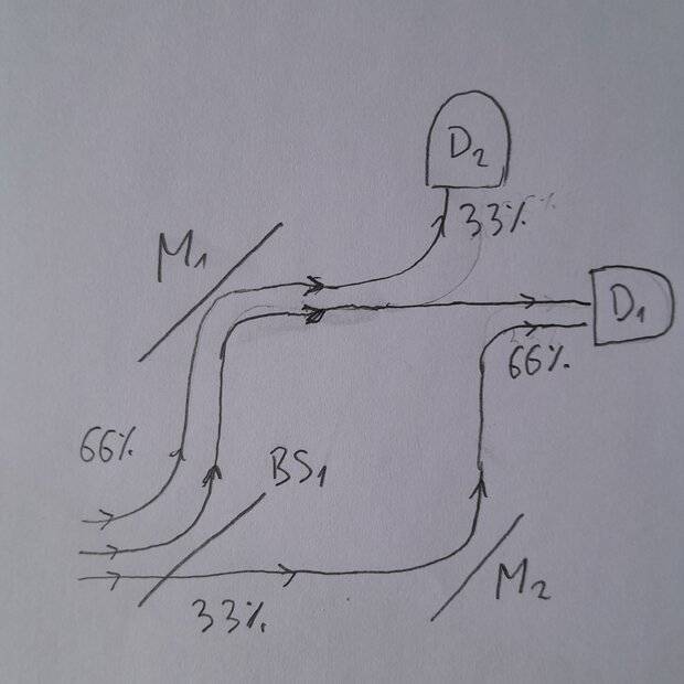

I've sketched what actually happens according to Bohmian mechanics. For simplicity I've taken the case of 66% - 33% beam splitter and presented 3 characteristic Bohmian trajectories. Both standard and Bohmian QM predict that 66% photons will end up in D1, and 33% photons will end up in D2.
Thanks for the sketch and info. One of the things that is possibly confusing is "Bohmian mechanics" versus the "Bohm interpretation" that Bohm's colleague Basil Hiley presents in the paper that I referenced.
One thing that could help me out: Can you look at the particle trajectories they show in Figure 3? The way they show it, particles arriving from M1 and M2 end up making a 90 degree turn in region I2, to end up ad D2 and D1, respectively. My question is this: if the beam splitter was asymmetric, would all particle trajectories continue to make 90 degree turns, or would some particles now go perfectly straight through I2, or could there be trajectories that shoot off at an angle, neither straight nor 90 degrees?
As my drawing illustrates, some will go perfectly straight, but neither will go at an intermediate angle.
