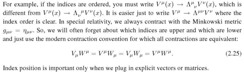

Be careful when using this book as Schwartz employs a strange convention for contracting Lorentz tensors - namely, he ignores the positioning of the tensor indices (i.e., whether they are "upper" or "lower" indices), as he explains in this passage:
With this convention you get ambiguous expressions such as ##\partial_\mu (g_{\mu\nu} \mathcal{L})##, which you've encountered here, and which are impossible to interpret as they stand. Besides, there is always the possibility of there being a typo in a particular formula. All this can lead to unnecessary frustration, so it is best that you supplement the Schwartz's text with other books on QFT that you can always consult. Never let a textbook gaslight you while studying! :-p
