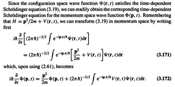

How do you get from (3.171) to (3.172)? In particular, why is
##\int e^{-ip.r/{\hbar}}\frac{p_{op}^2}{2m}\Psi(r,t)\,dr=\int\frac{p_{op}^2}{2m}[e^{-ip.r/{\hbar}}\Psi(r,t)]\,dr##? ##\,\,\,\,\,##-- (1)
For (1) to be true, it must be true that
##\int\frac{\partial ^2}{\partial x^2}[e^{-ip.x/{\hbar}}\Psi(r,t)]\,dr=\int e^{-ip.x/{\hbar}}\frac{\partial ^2}{\partial x^2}\Psi(r,t)\,dr##. ##\,\,\,\,\,##-- (2)
Using integration by parts and the fact that ##\Psi(r,t)=0## at infinity, I am able to show that (2) is true provided
##\int\frac{-ip}{\hbar}e^{-ipx/\hbar}\frac{\partial}{\partial x}\Psi(r,t)\,dr=0## ##\,\,\,\,\,##-- (3) or
##\int\Psi(r,t)\,(\frac{-ip}{\hbar})^2e^{-ipx/\hbar}\,dr=0##.##\,\,\,\,\,##-- (4)
But I don't know how (3) or (4) is true?
The author has left out steps leading to (3.171). The way it is written there, p is already an operator in momentum space, meaning that it is a simple multiplication.
Edit: Maybe it is not missing steps, but the author has taken the problem backward. I would start with the Schrödinger equation for ##\Psi(\mathbf{r},t)##, write ##\Psi(\mathbf{r},t)## in terms of ##\Phi(\mathbf{p},t)##, and get the Schrödinger equation for ##\Phi(\mathbf{p},t)##.

Since the integration in (3.171) is done with respect to r, shouldn't p still be an operator in configuration space?
How I see the steps leading to (3.171) is as follows:
Since ##\Psi(r,t)## satisfies the Schrödinger equation, any linear combination of ##\Psi##'s satisfies the Schrödinger equation too by the principle of superposition (or by the linearity of the operators in the Schrödinger equation).
Oh I got it now. The author used
##H\Psi(r,t)=E\Psi(r,t)=[\frac{p^2}{2m}+V(r,t)]\Psi(r,t)##.
So the p##^2## in (3.171) is a constant and not an operator.

In the equation you wrote, p2 has got to be an operator. It is in momentum space that it is a number.
I'm still trying to figure how to best approach the way it is presented in your book.

I think I got it.
##(2\pi\hbar)^{-3/2}\int e^{-ip.r/\hbar}\frac{p_{op}^2}{2m}\Psi(r,t)\,dr\\##
first substitute ##\Psi(r,t)## in terms of ##\Phi(p',t)##
##=(2\pi\hbar)^{-3/2}\int e^{-ip.r/\hbar}\frac{p_{op}^2}{2m}(2\pi\hbar)^{-3/2}\int e^{ip'.r/\hbar}\Phi(p',t)\,dp'\,dr\\##
then group the exponential terms together
##=\int\frac{p_{op}^2}{2m}(2\pi\hbar)^{-3}\int e^{i(p'-p).r/\hbar}\Phi(p',t)\,dp'\,dr\\##
since ##p_{op}## and the r integration commute, we have
##=\frac{p_{op}^2}{2m}\int(2\pi\hbar)^{-3}\int e^{i(p'-p).r/\hbar}\Phi(p',t)\,dp'\,dr\\##
since the r integration and the p' integration commute, we have
##=\frac{p_{op}^2}{2m}\int(2\pi\hbar)^{-3}\int e^{i(p'-p).r/\hbar}\,dr\,\Phi(p',t)\,dp'\\##
next perform the r integration
##=\frac{p_{op}^2}{2m}\int\delta(p'-p)\Phi(p',t)\,dp'\\
=\frac{p_{op}^2}{2m}\Phi(p,t)\\
I still have one unresolved question:
How does ##p_{op}^2## change from being ##-\hbar^2\nabla^2## to being ##p^2##, where ##p## is a number? At which step does it occur and why?

You cannot pull ##p_{or}^2## outside of the integral over r, since it is acting on that variable! You must apply it to the exponential and therefore it will generate a factor ##p^2## where now p is the variable, not an operator.

I see the mistake.
then group the exponential terms together (This step is wrong because ##p_{op}^2## is acting on ##r## but the exponential term has ##r## so they don't commute.)
instead it should be
##=(2\pi\hbar)^{-3/2}\int e^{-ip.r/\hbar}(2\pi\hbar)^{-3/2}\int\frac{p_{op}^2}{2m}e^{ip'.r/\hbar}\Phi(p',t)\,dp'\,dr\\##
##=(2\pi\hbar)^{-3/2}\int e^{-ip.r/\hbar}(2\pi\hbar)^{-3/2}\int\frac{p'^2}{2m}e^{ip'.r/\hbar}\Phi(p',t)\,dp'\,dr\\##
##=\int\frac{p'^2}{2m}(2\pi\hbar)^{-3}\int e^{i(p'-p).r/\hbar}\,dr\,\Phi(p',t)\,dp'\\##
##=\int\frac{p'^2}{2m}\delta(p'-p)\Phi(p',t)\,dp'\\
=\frac{p^2}{2m}\Phi(p,t)\\

Perfect!
