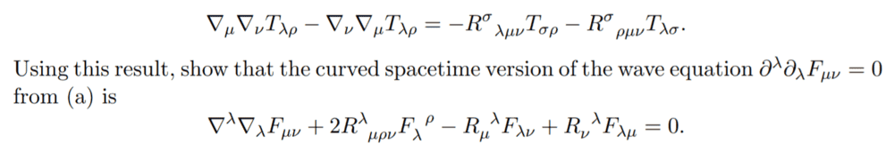

Problem attached as image
## \nabla^a F_{ab} = 0 ##
## \nabla_a F_{bc} + \nabla_b F_{ca} + \nabla_c F_{ab} = 0 ##
I'm confused by this question, from minimal coupling shouldn't the answer simply be ## \nabla^a \nabla_a F_{bc} = 0 ##? Any help would be appreciated.
EDIT: I should also point out ##F_{ab}## is the EM tensor.

You have not given the starting point and so the goal is unclear. Both expressions reduce to ##\partial^\lambda\partial_\lambda F_{\mu\nu}=0## in Minkowski coordinates on flat spacetime.

Thanks for the reply, I managed to work out the answer my issue turned out to be I wasn't taking into account that covariant derivatives don't commute.
