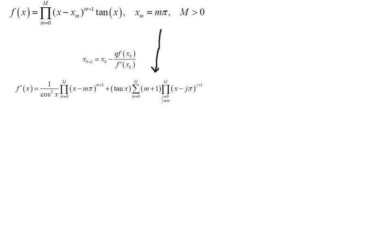

Handwritten arrow pointing down from the Newton iteration formula to the derivative f'(x) written as a product rule expansion with a sum and nested products over m and j.
i know the law (fg)'=f'g+fg'
but here there is epsilon
and it turns to someother sign i don't know what it says.
i can't understand the transition

There's no epsilon in what you posted. Are you talking about [itex]\prod[/itex]? Note that this is upper-case pi, which is different from the constant [itex]\pi[/itex], lower-case pi.
Upper-case pi is similar to upper-case sigma [itex]\sigma[/itex], except that it is used for products rather than sums. here's an example using the product notation.
[tex]\prod_{m = 1}^5 m = 1 \cdot 2 \cdot 3 \cdot 4 \cdot 5 = 5! = 120[/tex]
ok but why the derivative change epsilon to pi?
With epsilon do you mean the summation sign? If so that one is called capital sigma.
Taking the derivative of a function that is the product of two other functions yields two terms as you know, (fg)'=f'g+g'f. In our case we don't have a function consisting of the product of two functions but of a product of m functions.
[tex] \prod_{j=0}^m f_j=f_0f_1f_2 \cdot ... \cdot f_m[/tex]
Now taking the derivative of that product yields:
[tex] \frac{d}{dx}\prod_{j=0}^m=\frac{d}{dx}(f_0f_1f_2 \cdot ... \cdot f_m)=f'_0f_1f_2 \cdot ... \cdot f_m+f_0f_1'f_2 \cdot ... \cdot f_m+...+f_0f_1f_2 \cdot ... \cdot f_m'[/tex]
You can see that we get m terms that are added together and every term is the product of m terms. We can write this compactly as:
[tex] \sum_{i=0}^m \frac{df_i}{dx}\prod_{\substack{ j=0 \\ j \neq i}}^m f_j[/tex].
