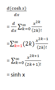

Hi... I read this from my lecture note, but i couldn't understand:
i) the red part, shouldn't it be k =0 instead of k=1?
ii) the third line to the fourth line... i.e.
I have no idea how to change from the third line to the fourth line..
Can anyone enlighten me? Thanks a lot.. :smile:
It doesn't matter. Since the terms being summed have a factor of "k", the k= 0 term has value 0.
In general, for power series, [itex]f(x)= \sum_{k=0}^\infty a_kx^k[/itex], the derivative can be written as either [itex]f'(x)= \sum_{k=0}^\infty ka_kx^{k- 1}[/itex] or as [itex]f'(x)= \sum_{k=1}^\infty ka_kx^{k- 1}[/itex] because the k= 0 term is 0.
By making the change of index, n= k- 1, so that k= n+1, the second can be written [itex]f'(x)= \sum_{n=0} (n+1)a_{n+1}x^n[/itex].
The first sum can be rewritten as
[itex]\displaystyle \sum_{k=1}^\infty (2k)\frac{x^{2k-1}}{(2k)!}=\sum_{k=1}^\infty \frac{x^{2k-1}}{(2k-1)!}[/itex]​
since [itex](2k)!=(2k)(2k-1)![/itex]. To change the base index, replace [itex]k[/itex] by [itex]k+1[/itex]. You then get the sum
[itex]\displaystyle \sum_{k=0}^\infty \frac{x^{2k+1}}{(2k+1)!}.[/itex]​
