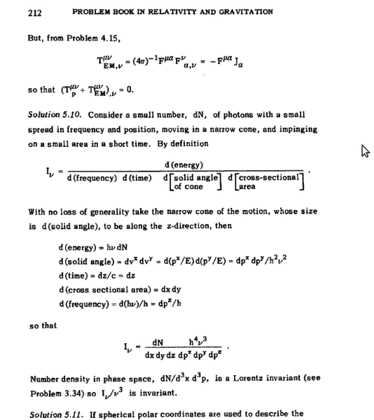

please see attached snapshot from the book of Ligthmann & al. (problem book in relativity and gravitation).
Can somebody please explain the expression for the derivative of the solid angle ?
here it is given as dvxdvy where the v's are speeds !
How come this is so ?

The solid angle is dvxdvy/v2 but the problem is about photons so v = c = 1 in natural units.
