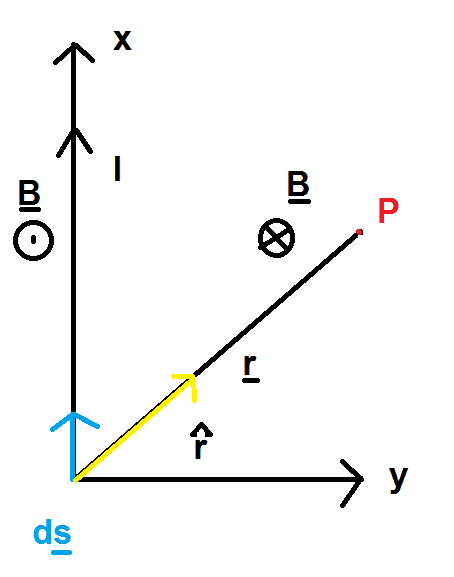

Basically I am deriving Biot-Savart's Law using the vector method. The one my book gives me is impossible to remember
http://img39.imageshack.us/img39/6584/pictureson.th.png
Uploaded with ImageShack.us
So I am actually just going to do the indefinite integral first, but I got so many differentials, it's ridiculous
[tex]d\vec{s} = <0,d\vec{y},0>[/tex]
[tex]\hat{r} = <\sin\theta,\cos\theta,0>[/tex]
[tex]\begin{vmatrix}<br /> i & j & k\\ <br /> 0& d\vec{y} &0 \\ <br /> \sin\theta & \cos\theta &0 <br /> \end{vmatrix} = -\sin\theta d\vec{y} \hat{k}[/tex]
So now my integral is
[tex]\vec{B} = \frac{\mu_0 I}{4\pi}\int \frac{-\sin\theta d\vec{y} \hat{k}}{r^2}[/tex]
Now here is the problem, I had trouble finding what r2 is, I decided to let it be [tex]x^2 + y^2 = r^2[/tex]
But then my integral becomes[tex]\vec{B} = \frac{\mu_0 I}{4\pi} \int \frac{-\sin\theta d\vec{y} \hat{k}}{x^2 + y^2}[/tex]
Now the problem is, I could do a trig substitution and let y = xtanθ
[tex]\vec{B} = \frac{\mu_0 I}{4\pi} \int \frac{-\sin\theta d\vec{y} \hat{k}}{x^2 + x^2 tan\theta ^2}[/tex]
[tex]\vec{B} = \frac{\mu_0 I}{4\pi} \int \frac{-\sin\theta d\vec{y} \hat{k}}{x^2 sec\theta ^2}[/tex]
[tex]\vec{B} = \frac{\mu_0 I}{4\pi} \int \frac{-\sin\theta \cos^2\theta d\vec{y} \hat{k}}{x^2 }[/tex]
Now the question is, how do I get rid of the x2?

Here is another attempt
[tex]\vec{B} = \frac{\mu_0 I}{4\pi} \int \frac{-cos\theta d\vec{y} \hat{k}}{x^2 + y^2}[/tex]
I drew my triangle again and I substitute [tex]cos\theta = \frac{y}{\sqrt{x^2 + y^2}}[/tex][tex]\vec{B} = \frac{\mu_0 I}{4\pi} \int \frac{-\frac{y}{\sqrt{x^2 + y^2}}d\vec{y} \hat{k}}{x^2 + y^2}[/tex][tex]\vec{B} = \frac{\mu_0 I}{4\pi} \int \frac{-y d\vec{y} \hat{k}}{(x^2 + y^2)^\frac{3}{2}}[/tex]
So I ran this on Mathematica setting my bounds from -inf to +inf and I got 0...which is bad...very bad
Please someone, Sammy S, gneil, anyone please lol
What are you using as your coordinate system? (The magnitude of a x b should be |a||b|sin(theta), and you have a cos(theta)...)
I know, my x is your standard "y" in this picture and vice-versa
Is this the way it is:
Edit: with theta between the x-axis and r...
I'm not quite sure how you've setup your coordinate system, but it might be easier if you define some angle phi = pi/2 - theta and integrate in terms of phi...
(Of course, if the wire is infinite, the easiest way is to use Ampere's law...)

No I already know how it was derived. I know what you are getting at because that's the one the book used. But I didn't like it because it was too difficult to remember. This one I find much more intuitive. No Ampere's law please

From your first post, I believe your r-hat should be [itex]\hat{r} = \langle \sin(\theta), \cos(\theta), 0 \rangle[/itex].
What can you possibly mean by: [tex]d\vec{y}\hat{k}[/tex] in your integral?
Mathematica may have interpreted that as a dot product of those two vectors, which does make zero the answer.
No I left out [tex]\hat{k}[/tex]
I just typed in int{y/(y^2 + x^2)^(3/2),y}
No from the way I defined x and y, it is different
Because I get the correct answer if I use that r-hat.
The way you have your angle defined, x = rsin(theta) and y = rcos(theta)...
But your theta is wrong, at least in my picture it is wrong.
x is the green line, right? Then if theta is between r and y (the line ds is along), then x = r*sin(theta)
yeah, you had [tex]<sin\theta, cos\theta,0>[/tex]
Your vector is in <x,y,z> form, right? Then x = rsin(theta), y = rcos(theta), and z = 0.
Wait you may be onto something...*goes and fix tex*
